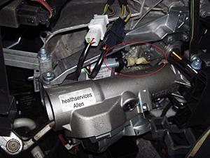

Update: FIXED!
$11 part and $450 in labor. Thank goodness for the warranty. My coupler in the steering column motor area snapped.

I just had this problem myself. I was able to replace the coupling if anyone needs help getting to it I could write how. You have to remove the bottom part of the dash to get to it and it take awhile to do but its not to bad.
I had this problem for a while (last March) and have been trying to find a way to get to it. Please post some info for removing it.
I have pmed you too.

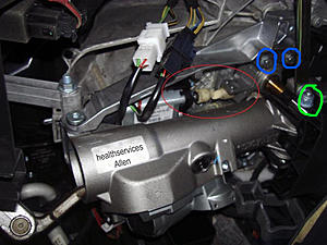

health services, to get to it I completely droped the steering wheel all the way then got to the part from the top.
look at this https://mbworld.org/forums/audio-ele...e-up-down.html
There are 4 bolts, two on each side of the steering wheel attached to a metal plate that you get to from the bottom. Then there is a large bolt that you remove from the side of the steering column. Once you do that the steering wheel should fall down. and you will have access to the part.

I used your picture to show the bolts. The blue are the 4 bolts and the green is long bolt on the side of the steering column u need to remove.
WOW I saw the other thread on the W203... looks difficult
on your W209, it's only 4 bolts (blue cercle) and 1 long bolt ( green cercle) ?
yeah..... after taking out 50 screws holding the lower dashboard on and removing the instrument cluster
