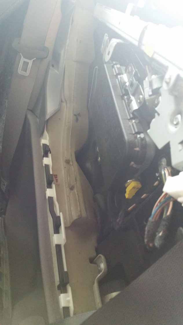

Old Mar 12, 2016 | 04:25 PM
myclk350's Avatar
Joined: Apr 2015
Posts: 21
2006 CLK 350
Need some help here, I'm trying to replace my seat belt and I couldn't get the bottom panel off, how do you unclip the bottom panel 8. I got stuck on step 15 of the instruction. Thanks
Old Mar 13, 2016 | 10:52 PM
myclk350's Avatar
Joined: Apr 2015
Posts: 21
2006 CLK 350
Never mine I figured out, finally removed the old seat belt and install a used seat belt that I bought from Ebay and the seat belt wouldn't retract and I got a SRS warning error. I think there is something wrong with the seat belt that bought that causes the SRS warning. I tried to reset warning with my OBDII but luck. I think the seat belt locked up due to an accident before. Not sure how to unlock the belt. Any info would be appreciated, thanks.
