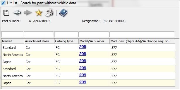

I checked the EPC for one part # of the CLK63 springs ( 209 321 04 04), ran a search using that #, and only the CLK63 coupe and cab came up. It looks like those springs are only used in those models.

When I check the EPC it shows that the CLK63 Coupe (209.377) and the CLK63 Cab (209.477) share the same spring part #s, but different shock/strut #s. The BS is the only one that uses the coil over setup.

I could confirm that it's not. Here is the info for the CLK63 coupe front springs and the CLK500/55 front springs. You could see that all the springs they use for the CLK500s/55s all start with (203), meaning they were also used for the C-class. The springs that come on the 63 start with (209). You could see the difference in the parts search. Using the 63 spring #, it brings up only 2 application, the cab and coupe. Using one of the 500/55 spring #s, it brings up a whole mess of models.

Thanks again for you help, bud... and for taking time to post up illustrations.
