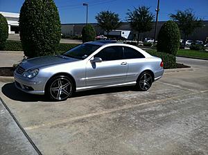

Hadn't been on the forum in a while. I put the sonictunning's group buy wheels on my car. Here's a pic, thought it was a good deal for $600. As you can see in my sig I had the C63 style wheels before.

600 for 4????
fishy, but they do look nice..........

For that price cant really argue however I prefer the C63 style wheels on your 209...

looks good but if the car is lower it will look way better.

nice... avanteguard style.... looks much like my wheels w/o the lip

looks great.

I always wanted to see these wheels on a clk... looks good

I really like that wheel but I am surprised that it doesn't look as aggressive as I thought it would on the CLK. Anyways, sounds like you got a hell of a deal on them and if you're happy, that's great.

nice!! like them but I agree if lowered it might be more agggggressssssive

Looks great and $600 is a smokin deal!

I love those wheels, what size are they?

Thanks all! They are 18 X 8.5 and 18x 9.5. I wish they had the ///AMG markings.
