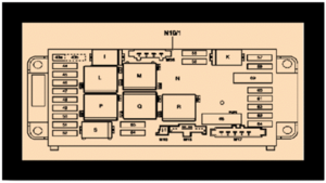

Got it all fixed. Since I could not find a solution to this problem with my googlefu, I will post what I found for future reference for others.
It was a blown fuse...in the 43a and 43b position. The fuse box is located in the engine bay by the firewall, on the driver's side. There is a horn relay also, if the fuse is not the problem...relay 'I' to the right of the fuse.
