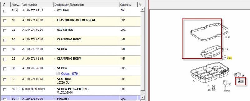

I am planning to buy the Shell ATF 134 case tomorrow, in the attached picture, I am planning to get Gasket, Filter and screws.
Am I missing any other part? As I mentioned earlier, dealer is asking $70 for these '3' things. Any other place where I can get these parts, less than the above mentioned price?

For the parts, check places like rmeuropean and autohausaz. But honestly, you'll probably not save enough to make it worth your trouble shopping around. In addition to the dipstick, invest in an infrared thermometer to check the temp on the transmission pan (unless you have SDS which can give you the fluid temp electronically).

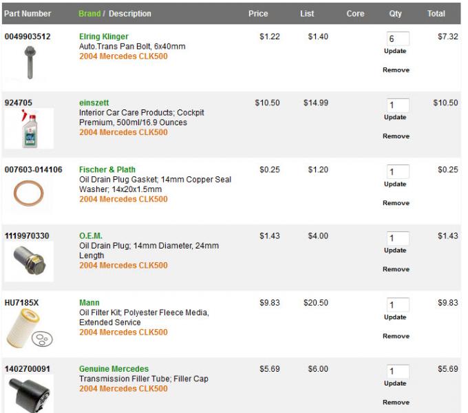

Faran, your Autohaus shopping cart isn't "shareable". You need to link to each part, but that should be the filter, gasket, drain plug gasket (but you probably don't need that), and the pan bolts. The reason you don't need the drain plug gasket is that you don't have to remove it - you can drain the pan as you remove it (just have a big pan to catch the oil).
Old Mar 31, 2013 | 12:31 PM
  #37
faran's Avatar
Joined: Dec 2012
Posts: 216
2004 CLK 500 with AMG Package, Not Convertible
Thanks for the tip about the cart, I just checked in a different browser and it didn't open.
Apologies for that
Please have a look on the attached images, it has the parts screenshots in it.
As always, thanks for the help

That order looks about right to me. Like I said, you really don't need a new drain plug and washer if you just let it drain as you remove the pan. Also, you may not need a new lock and seal for the filler tube - the old one will still snap in place and seal with the locking tab removed. Most people would only replace this in case they were taking their under-warranty car back to the dealer so it would appear to still be factory sealed.
Understand, that makes perfect sense.
I can get Free shipping for an order above $50
Going to revise the order and order the parts, how about the dip-stick link, which one you recommend?
Thanks again Rudeney

Good deal on the ATF 134 - I had heard someone else say Shell can give you a local dealer. I won't need any for a while, but I have a friend who wants to do the service, so I may try this for him.
On the Mobil 1 from WalMart - check to make sure that is MB Spec 229.5 - I once grabbed a 5 quart jug there and when I checked, it was not the right stuff. Mobil 1 0w40 "European Formula" is what you want - and make sure you find the 229.5 certification on the bottle.
