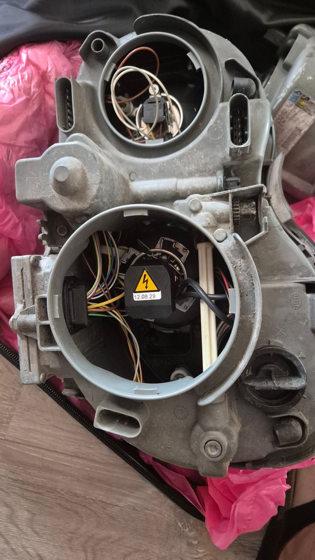

Hello guys , hope you're doing , im an owner of a pre-facelift clk w209(2005) and im doing the same thing , i bought two bi-xenon headlights and i want to install them
my car has the halogen headlights with one plug(5 pin) and the one i bought has 3 plugs(6pins,5pins and 4pins)
not sure where to my plug my original harness plug
any idea please that can help me , thank you
Ps: i know that i have to set the xenon=present setting
My original plug
My original plug
New xenon headlights
