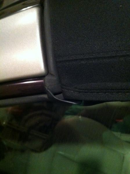

I was looking at my hood arrangement and wonder if part of yours is missing or plugged.
The fabric hood has a small built in perfunctory “drip rail” that leads down to a small rubber “funnel” (for want of a better word) which is part of the A pillar molding. If that funnel was plugged, or had become detached for some reason, you would experience the wet leg you are enjoying.
Just a thought
Attached Thumbnails Is this leak expected?-photo-5.jpg   Is this leak expected?-photo-3.jpg

There are actually two water drain in the A pillar rubber. One collects any water that makes it into the rubber channel on the top of the windshield and the other collects water from the fabric "drip rail" stitched into the canvas. If you slowly pour water into them, you should see it drain out in between the fender and door. The side window does need to he raised as one of the channels sits against the glass.
