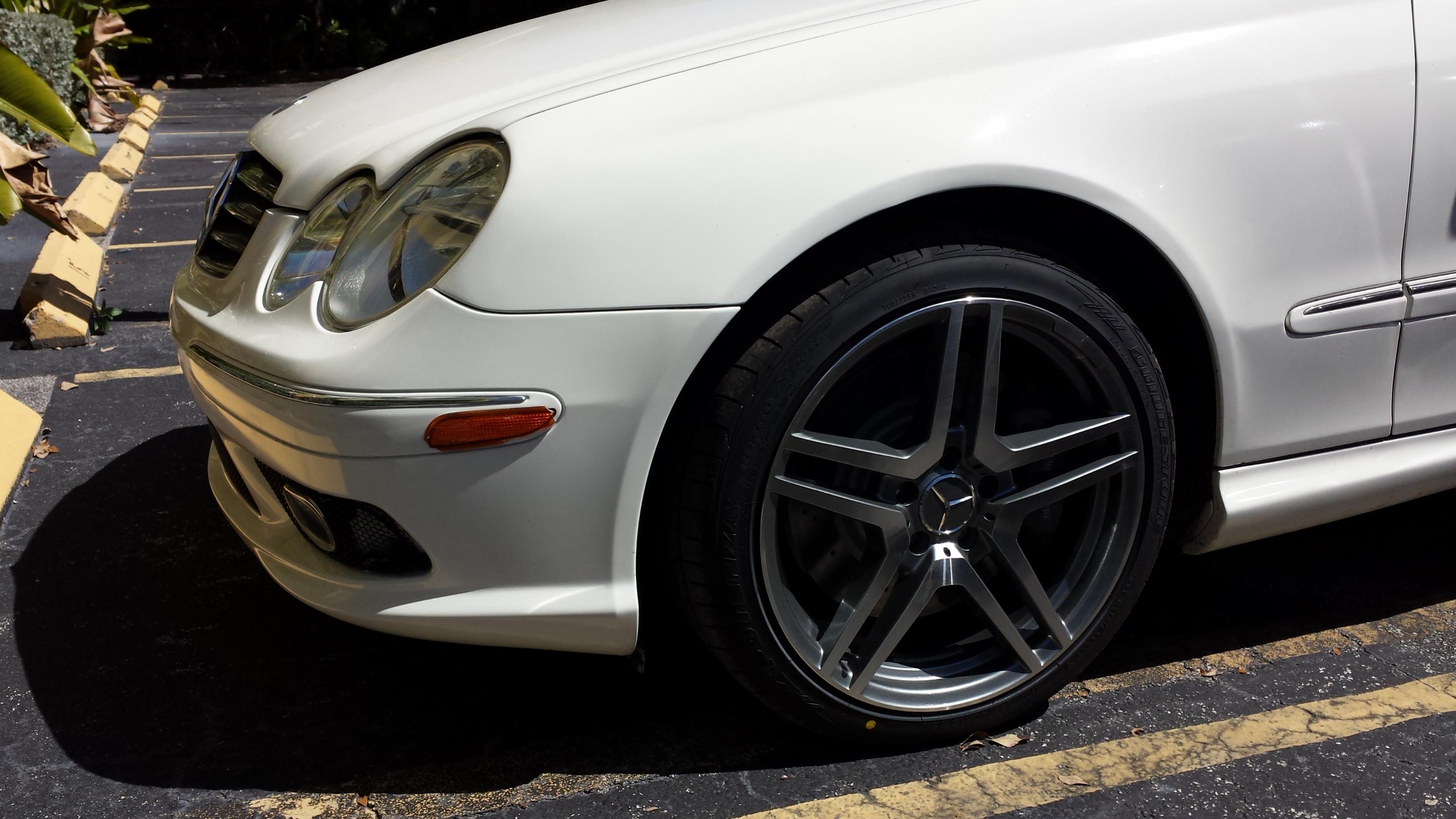

I have diligently searched the forums for my specific scenario and wanted some opinions on what i should do next. There hasn't necessarily been a specific answer. I had the clicking sound in the front wheel well and a bad ride. I just purchased my 2004 clk500. Cabrio. Now I went ahead and made investement in changing the following up front.
-Lower / Upper Control Arm, Sway bar links. and it seems my ride is still overwhelmingly bumpy. I feel every single bump in the road and my car feels weird when i hit larger bumbs. Almost like there's some kind of torsion in the body. What should i change next ? maybe some has had a similar experience.I thought my car would ride like new after changing this. So im quite dissapointed. I have a buddy that has the same car non cabrio and it rides muchhhh smoother/bumpier.
fyi: ive also just purchased new 18" wheels from powerwheelspro / with new tires so ive ruled that out. fyi they looked lovely.
your feedback and opinions are much appreciated.
