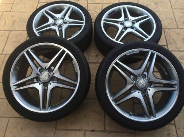

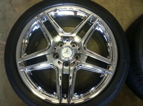

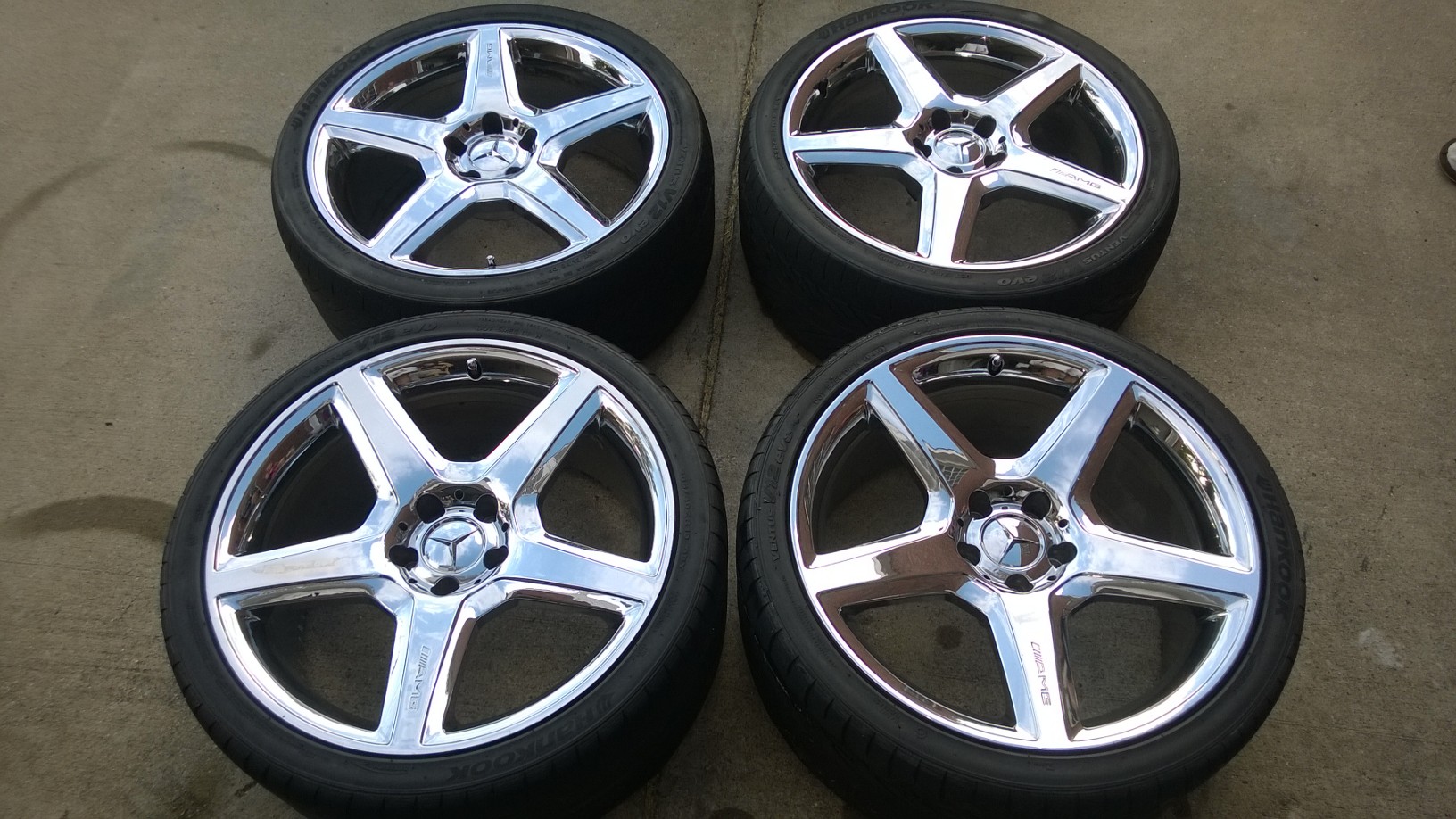

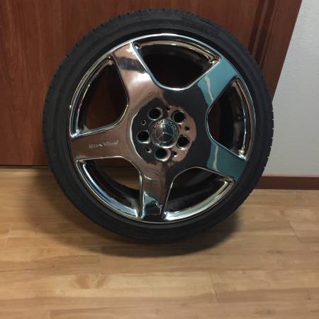

I'm mainly looking for these wheels:
Attached Thumbnails AMG wheels-0161.jpg   AMG wheels-amg2.jpg   AMG wheels-img.jpg   AMG wheels-wp.jpg   AMG wheels-z5.jpg

I currently have these in silver but am looking for them in chrome.
