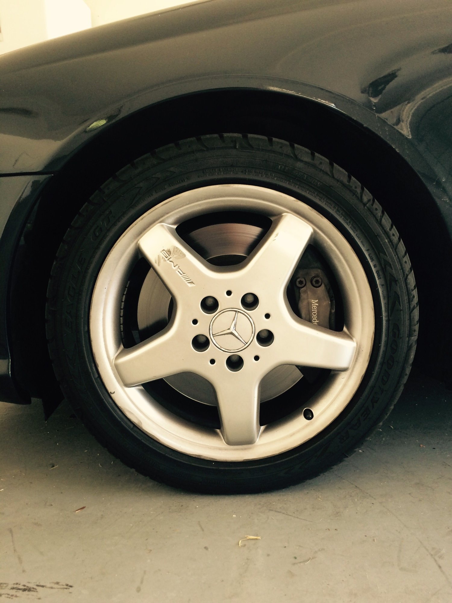

What's up everyone. I've done what I could to leave my car practical but yet adding the small things.
I have quad exhaust, green filters, fresh brake pads, and removed my spare tire for weight loss. Along with a fresh oil and coolant change.
Are there any lighter rims besides the stock staggered amg wheels I have?
Also, if I'm going to purchase drilled/ slotted brakes what brand should I purchase?
Thanks.

Stock wheels are very heavy. Just about all wheels are lighter. I would copy the stock CLK55 wheel setup (sizes and dimensions) in an aftermarket lightweight rotary forged wheel.
Why do you want to upgrade your rotors? Unless you are on the track I would stick with the solid stock ones for reliability. If you are tracking it then you probably want to upgrade the whole brake system.

I have stock 18" AMG that came from the factory. I don't plan on any wheel upgrades but if I were I would choose the TSW nurburgring's. They come staggered in sensible dimensions and are very light and affordable, 18x8 front and 18x9 rear.
Of course it depends on what you like and what you want to get out of it. I don't like showy rims in the slightest and usually look for very lightweight practical options that will improve performance. If you can find a rim around 20lb's you are doing well. Bear in mind most show orientated rims are at least as heavy as stock if not much much more and will hurt performance greatly- acceleration, braking and cornering. I would stick to 18" and definitely not go bigger. All my opinion of course.
