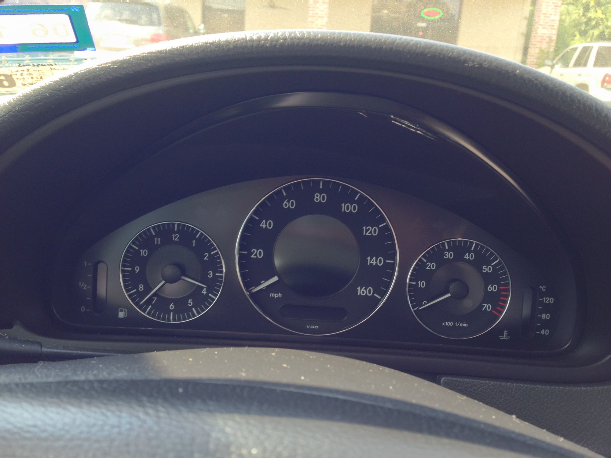

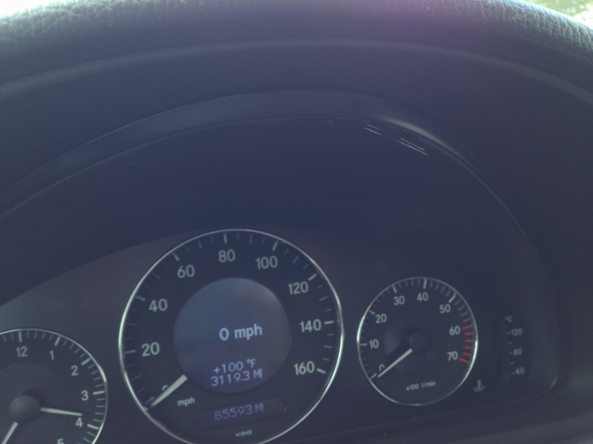

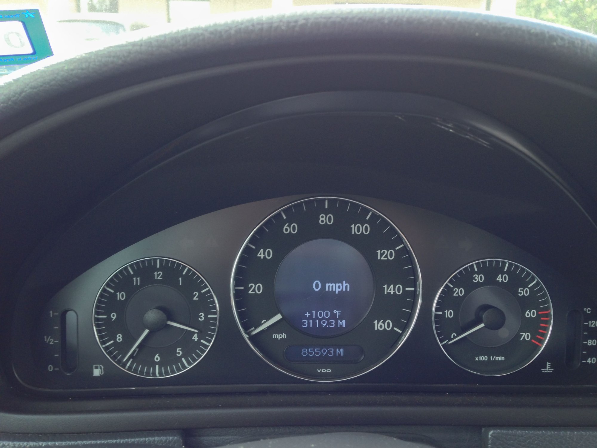

Has anyone seen anything like this before?
There is a weird shiny spot at the top of the cover for my speedometer panel.
I swear it wasn't always there, and I swear it is spreading.
I just noticed it a couple months ago, and at first I thought it was just a light reflection, but it seems to be there regardless of the type of lighting - night/day/sun/shade etc.
Should I be concerned that it is going to spread over the whole area?

Looks like what you are seeing is light being refracted in tiny cracks in the plastic. Cant tell if the cracks are deep, or just crazing in the surface. Either way, there is really nothing you can do about it.

Can you fell any deformation, as from being scratched, when you rub a finger across it?
Have you tried cleaning it?
You can try a clear plastics cleaner (I use Meguiars). I've found it works really well with a bit of pressure. I use a rubber sanding block covered with a microfiber towel. Using the edge of the covered block, I dampen the towel at the edge and rub with pressure back and forth. Then wipe with a dry portion of the towel.
I think this stuff actually removes and/or alters the plastic surface.
