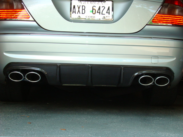

I see you have the 550. I installed the VIS CF rear diffuser and the black plastic piece was not removed. I cut into it for the passenger side exhaust exit, but it is still on the car and covered by the VIS.

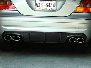

The bumper on a 500 is likely different. It was time consuming on the 550 (who wants to mess up a $400 part) but relatively easy to install. One edge that rolls under the fender was difficult, so I followed someone's prior and used JBWeld for that small (couple inches) section. The rest was just taping, aligning, and holding it in place while the tape cooled.
There was a DIY post on the install out here at the time I was installing. I think the DIY was on a 500.

It fits flush....
