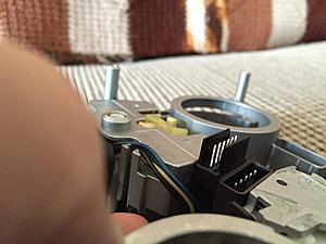

So I found the issue. Don't know if anyone else has had this but hopefully this helps someone out there someday. The pinout on my new switch is not the same, they are recessed into a shroud around them where my car needs one where the pins are protruding farther. The part number for my 2006 CLK is
A 203 545 01 10, the part number I got is A 000 545 23 10. Not sure where the 000 is used or if it's older but clearly are just slightly different.

Don’t quote me on this but I believe you have bought a different switch .Try getting a new switch with matching numbers then go from there .
