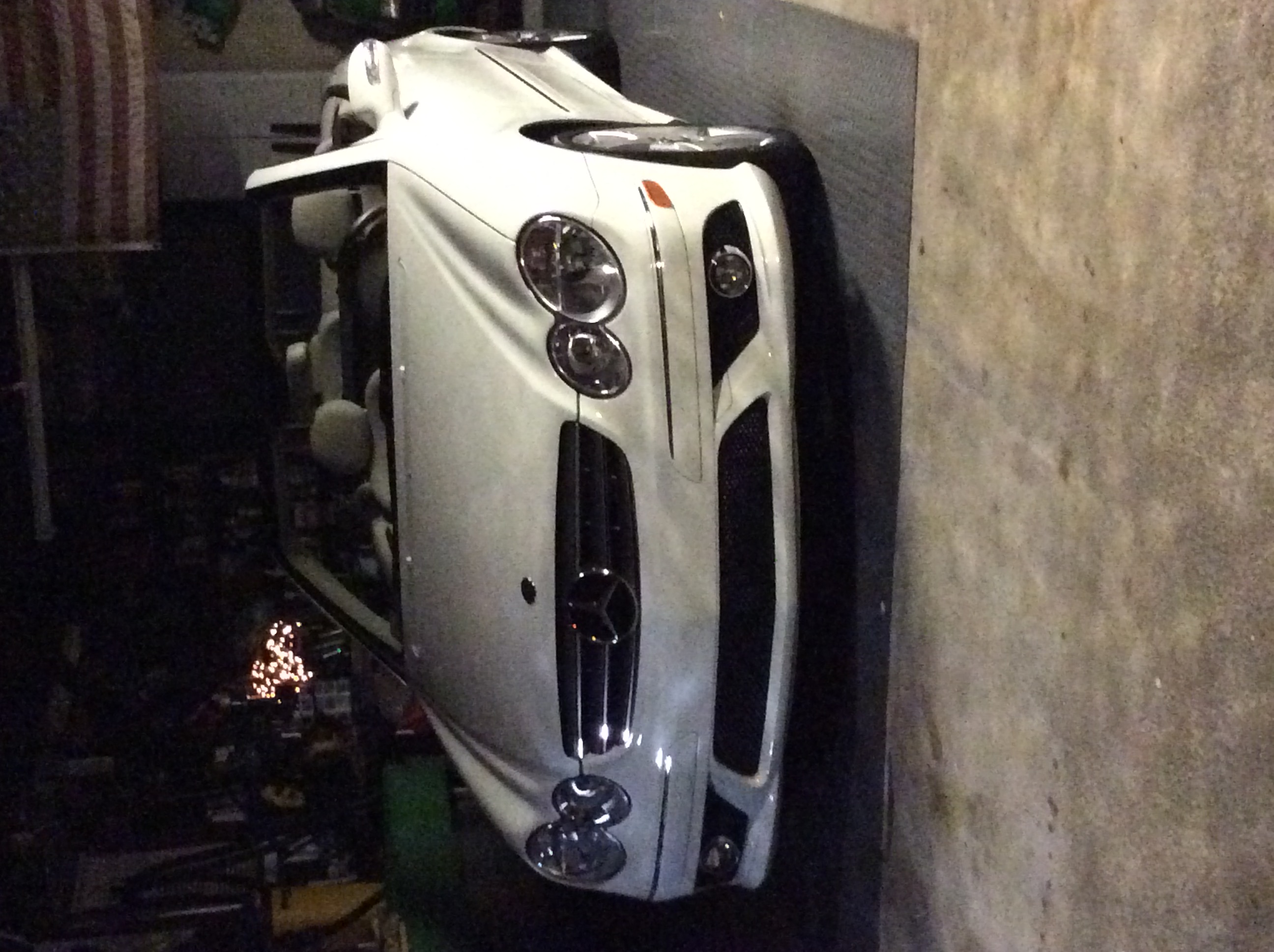

Whats the best way to remove a rear spoiler?
I understand that they are put on at the factory with 3M tape..
I'm thinking about going to a black spoiler.
Any advice..?
