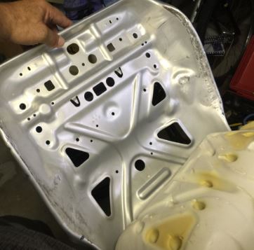

Undo the clips that hold the material on the frame lip. The padding won't come all the way off, that's okay, just fold it back.
Use the hammer (with gusto) to flatten the top/flat edge to be parallel with the pan. Continue hammering while holding the seat frame at an angle to reshape a little wider, it wont go far.
Use the flat head screwdriver pry the lip enough to refasten the clips for the seat cover.
Only hammer the sides, do not hammer where the humps are in the pan, as that is for the motor.
I've thought about also trimming some of the padding on the side, but it's been good for me.
Reinstall the seat.
It would be easy to make this much longer, but this should be sufficient.
If you are not familiar with metal working, please get someone to help you, as if you break the seat (would take a lot, its good metal) you'd need a new seat.
