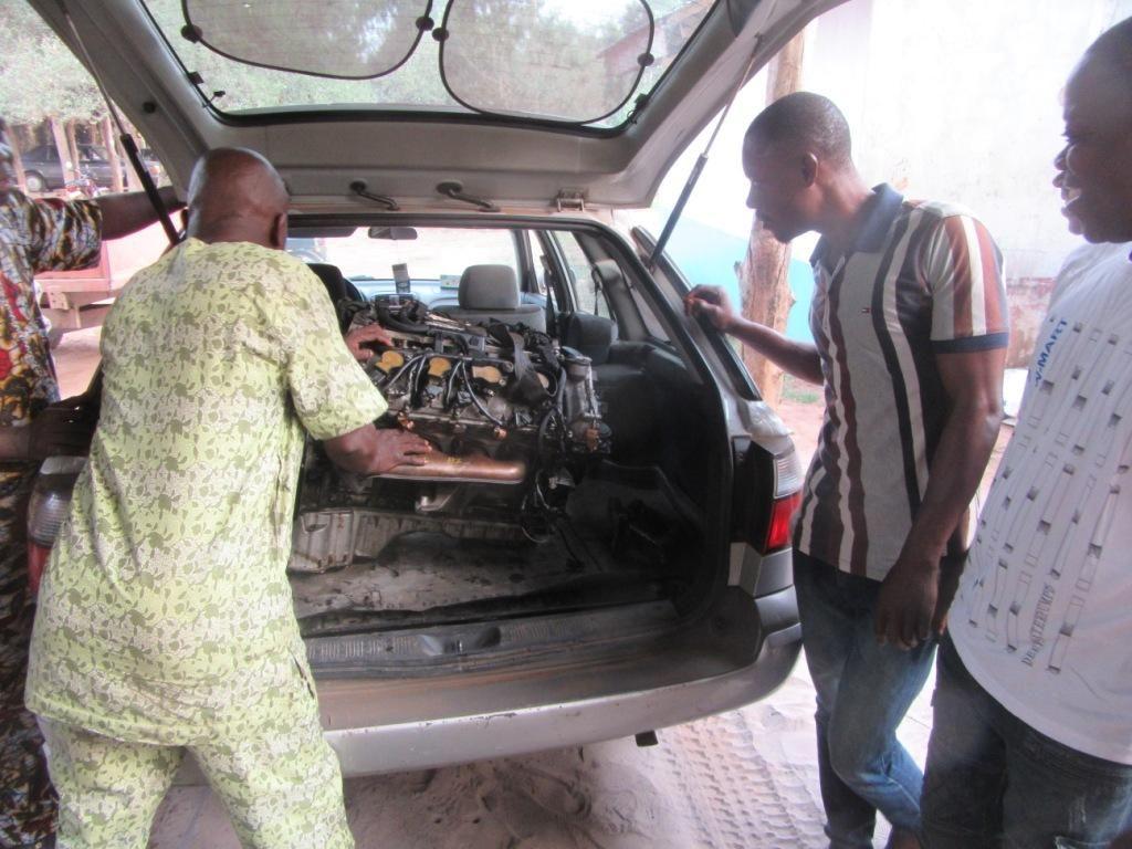

The replacement M273 engine is delivered from the junk yard. This motor is evidently from a Mercedes S550 of 2008 vintage, so the engine mounts and water pump were swapped out.
The replacement engine is manhandled out of the tiny hatchback that delivered it here.

Fascinating. What did you have to pay in USD for the engine? That's the first time I ever really looked at M273 con rods. They are sort of delicate looking. I'll think of that every time I torture them from here on out.
I wound up paying the equivalent of $2,500 USD for this 2008 M273 engine, which is about the going rate for an "as is, ought-to-run" M273 V8 engine stateside. Luckily the outgoing engine provided all the external components that were either different from the ones on the junkyard engine, or just in better condition. Most of the M273 engines that were spotted here were from the problematic 2006 and 2007 years, so I passed on them, and waited until I heard about this engine whose 2008 serial number only calls for the replacement of all camshaft solenoids on the newly acquired engine, with the ones taken off the water damaged motor, all else being equal.
Those junkyard engines are tossed in heaps where they are stored, and dragged apart as needed for sale, so my original car engine's wiring harness, water pump and a serpentine belt pulley all came in handy as replacements for the expected assortment of damaged ancillary parts on the engine I just bought. The replacement motor does appear to have clean plugs and exhaust ports, with clean oil and no metal shavings in the oil sump, so it should run just fine, once it is ready to be fired up, but if it doesn't, it'll get it sent back for a replacement, which is an outcome I'd rather didn't happen, given the rarity of late model 2008 or newer M273 engines in the local market.
