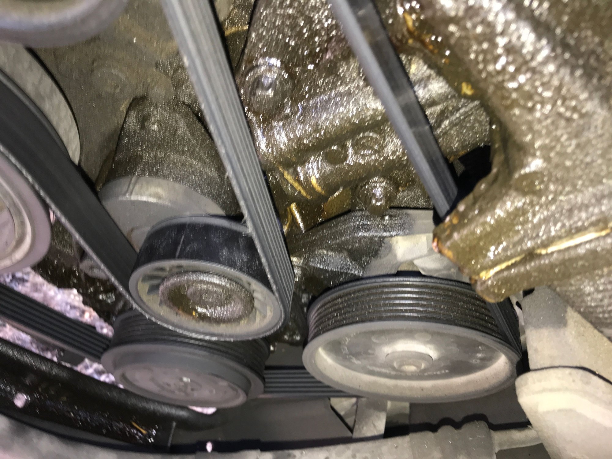

This car drove very well, no noises from the suspension, FSH, Michelins all round etc etc but had an engine warning light on, along with a low oil warning. It was obvious that someone had been topping up the oil regularly.
I noticed an oil leak (picture attached) and read the codes, showing up several faults (picture also attached)
So, do we reckon the engine is toast? It’s half the price of the others which are generally in poorer condition in terms of suspension, bodywork etc. I’m not afraid of taking on a project but equally I don’t have the skills to change an entire engine.
Advice would be appreciated.
Thanks

I'm sure some of the guys who really have experience correcting some problems you noted will reply. In the interim, my 2 cents;
- The random misfires could be due to faulty/damaged/just old spark plug/ignition coils/wiring. particularly if the car spent most of it's time outside (not garaged).
- The oil seems to be coming from the driver side top. You can inspect the valve cover, filter cap, oil cooler. The filter cap housing can be cracked.
- Things being "stuck" open or closed may be an indication of a very dirty/sludge engine. It may clean up with a couple uses of seafoam and a couple changes of quality oil.
- The camshaft position sensor may be defective.
Maybe other forum members can help with an assessment on whether the engine is "toast".

How can that car be running well with a broken intake manifold, random cylinder misfires and possibly balance shaft issues? The oil leak is probably unrelated and the least of that car's problems. Personally, if this car wasn't like dirt cheap and I had the budget, tools and know how to fix it, I would run away from it.

Thanks guys, guess I'll give this one a miss then.
To clarify, when I said it was running well, I meant the transmission, interior, suspension, interior gadgets etc were in good order. The engine felt down on power but sounded OK. More than happy to change sensors / belts etc, but this sounds beyond my level. I'll keep looking.
Appreciate the help
