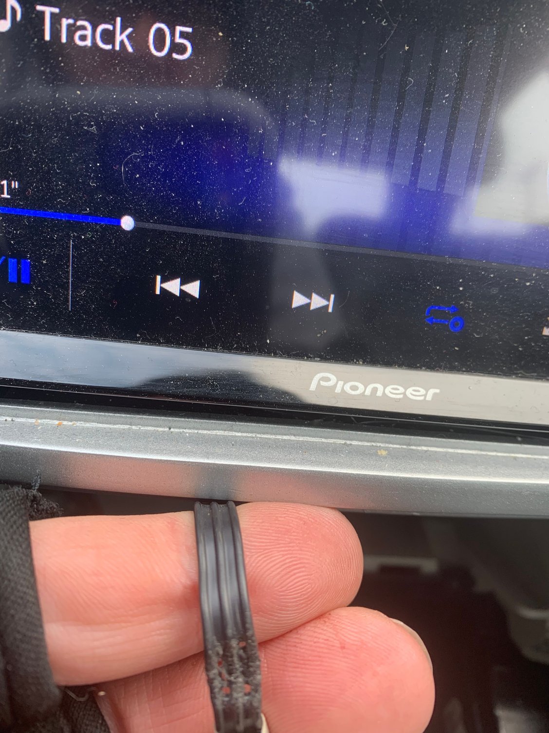

This is the wire

Looks like the installer of the radio caught the 3 wire cable between the radio and something, check it carefully to make sure it didn't cut through the insulation. If it did it could have caused a short. If just squished then maybe OK. Either way it needs to be repaired by properly soldering and putting shrink wrap on it. And that's assuming it's just 3 individual wires and not an optic cable. Looks pretty beat up to me. This is all the installer's fault, he needs to be responsible and get it fixed or take it to MB and send him the bill. If this is indicative of the quality of his work I'd wonder what else is messed up, hate to sound negative.

Taking it back to the installer is unfortunately out of the question. The car ran fine but didn’t have heat, would say my right front parking light was out when it wasn’t, and the headrest issue. The thing with the lights and horn just started sunday

I hear you about not taking it back but that damage didn't happen by itself, good luck
