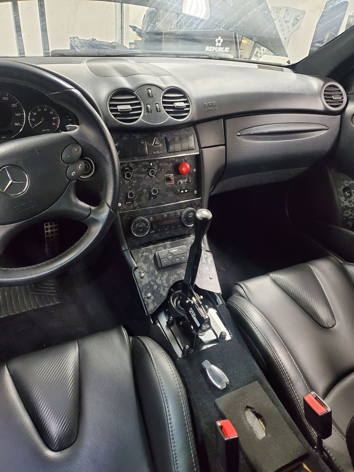

clk550
I did it on a 2007 clk550 and it worked great. The transmission felt strong enough for the V8. I wouldn't do it on a clk63 I think that the torque of that engine would destroy the transmission.
