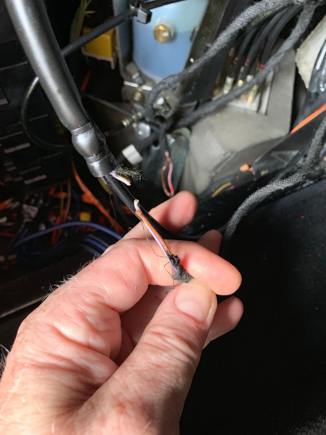

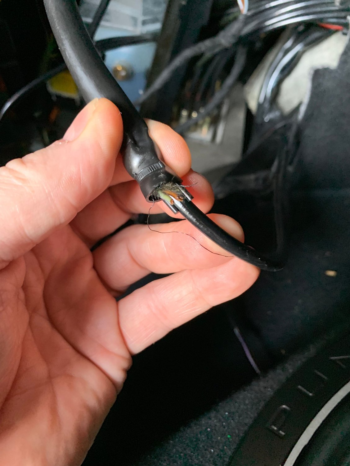

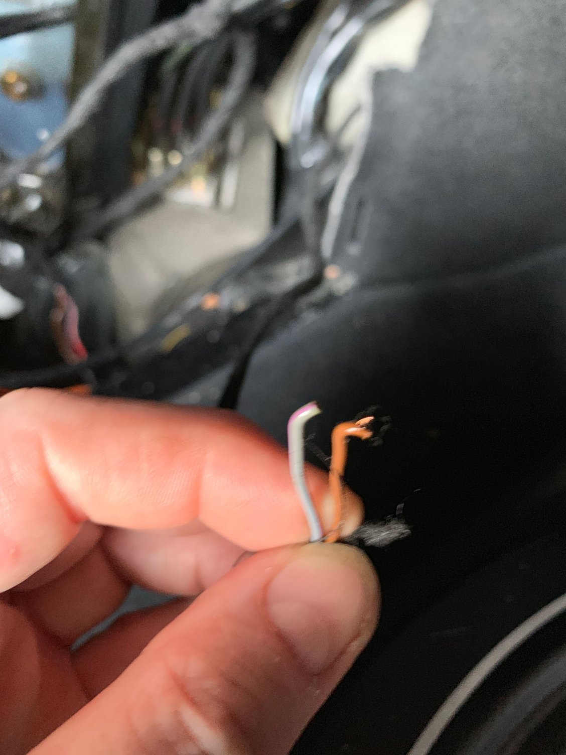

Broken wires
This is is the rubber wire conduit going to the chrome switch on the rear cover. Open circuit ecu never saw a switch closer. Just saying not always bad parts

Very interesting to know. I also oberved this flexing setup during my investigations after soft top failure and thought this looks curiously exposed. How did you re-establish connection? Did you weld or bridge the wires?
Solder and heat shrink tubing. Tape up the whole harness.
