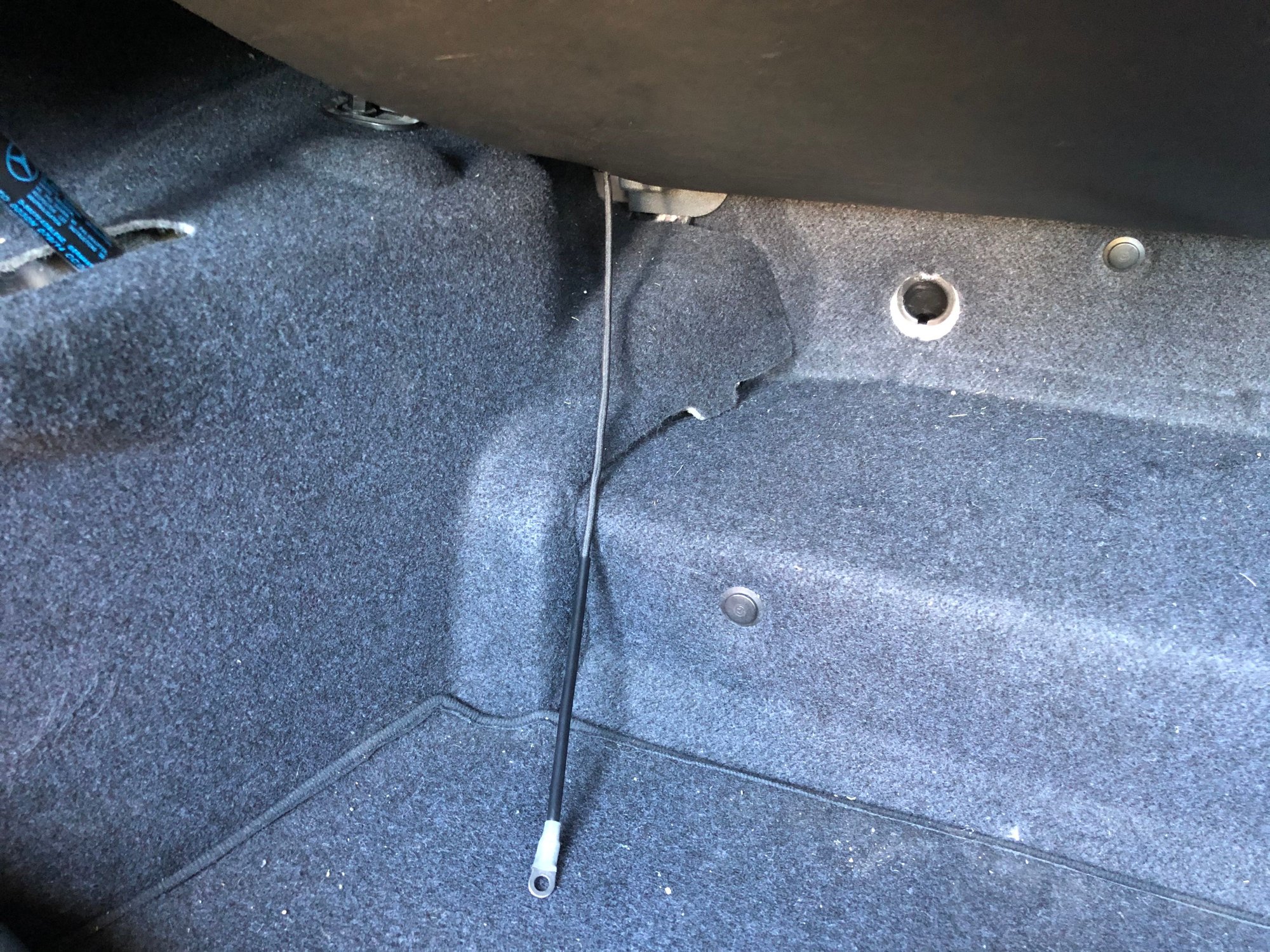

I was poking around again just now and found this elastic with a ring loose in the trunk... Any idea what this is? Thanks!

I've answered my own question about that elastic... There are fabric covers on each side of the trunk, and the left side has fallen off. That explains the weird piece of fabric I also found in the trunk!
