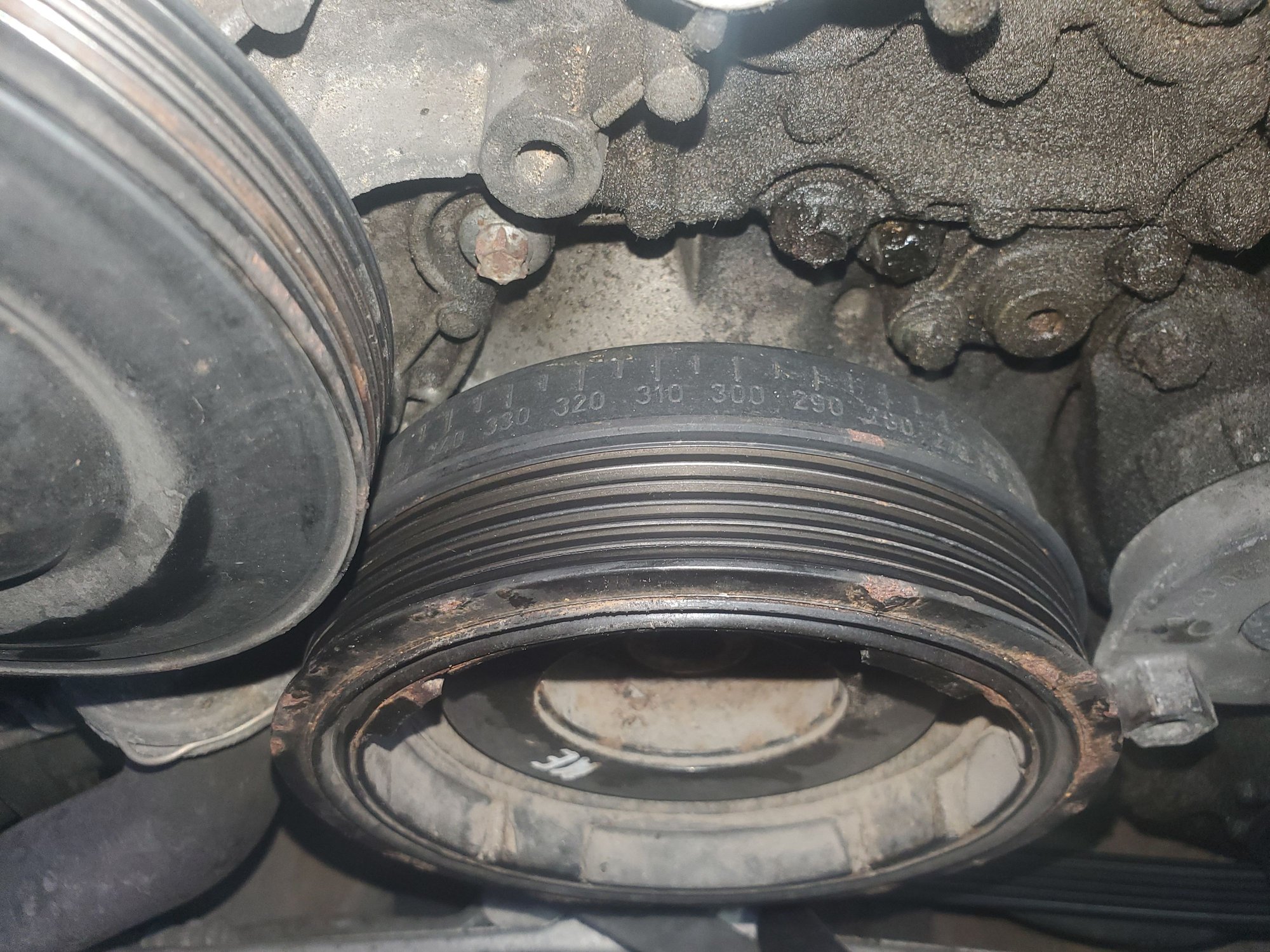

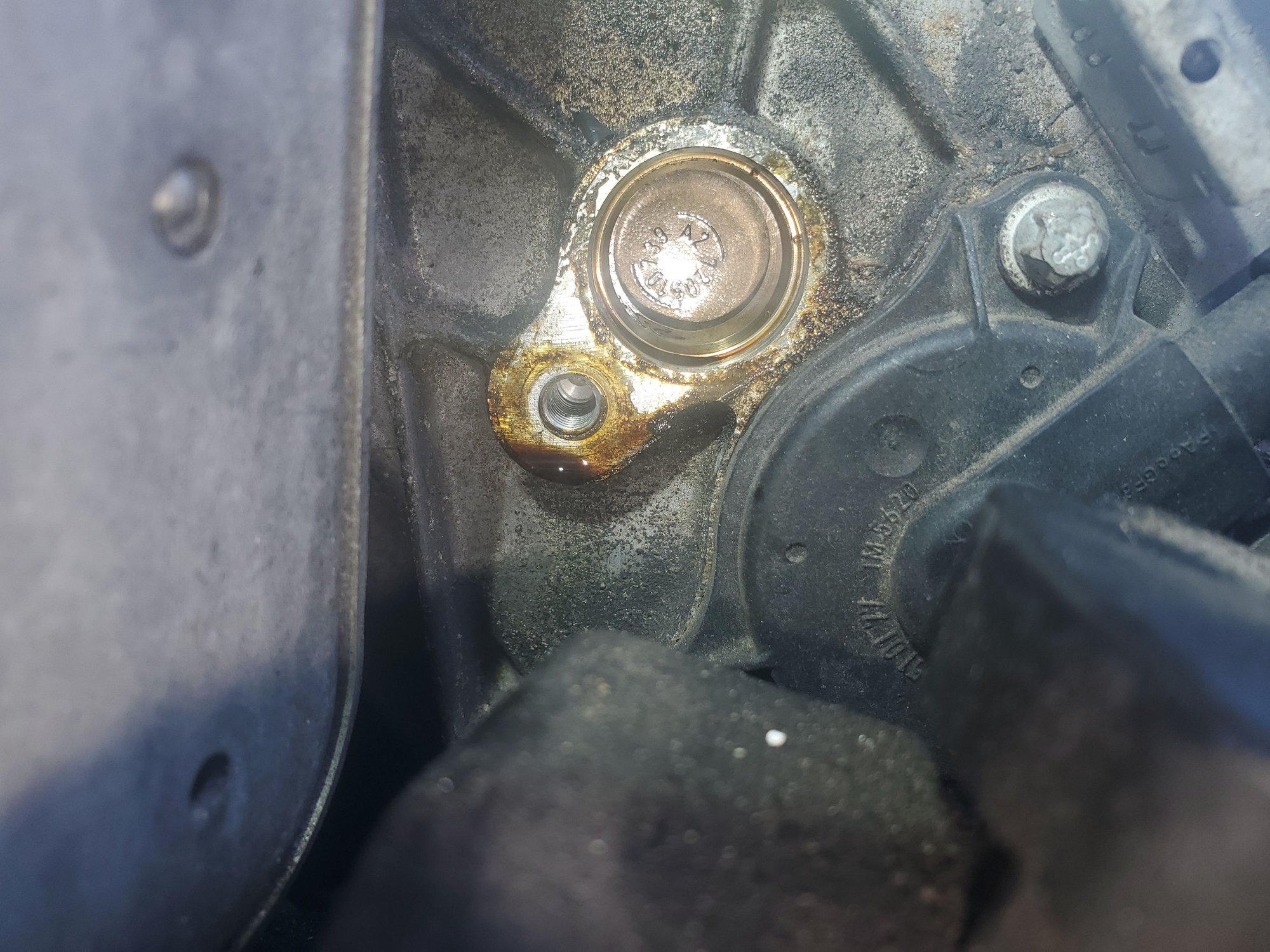

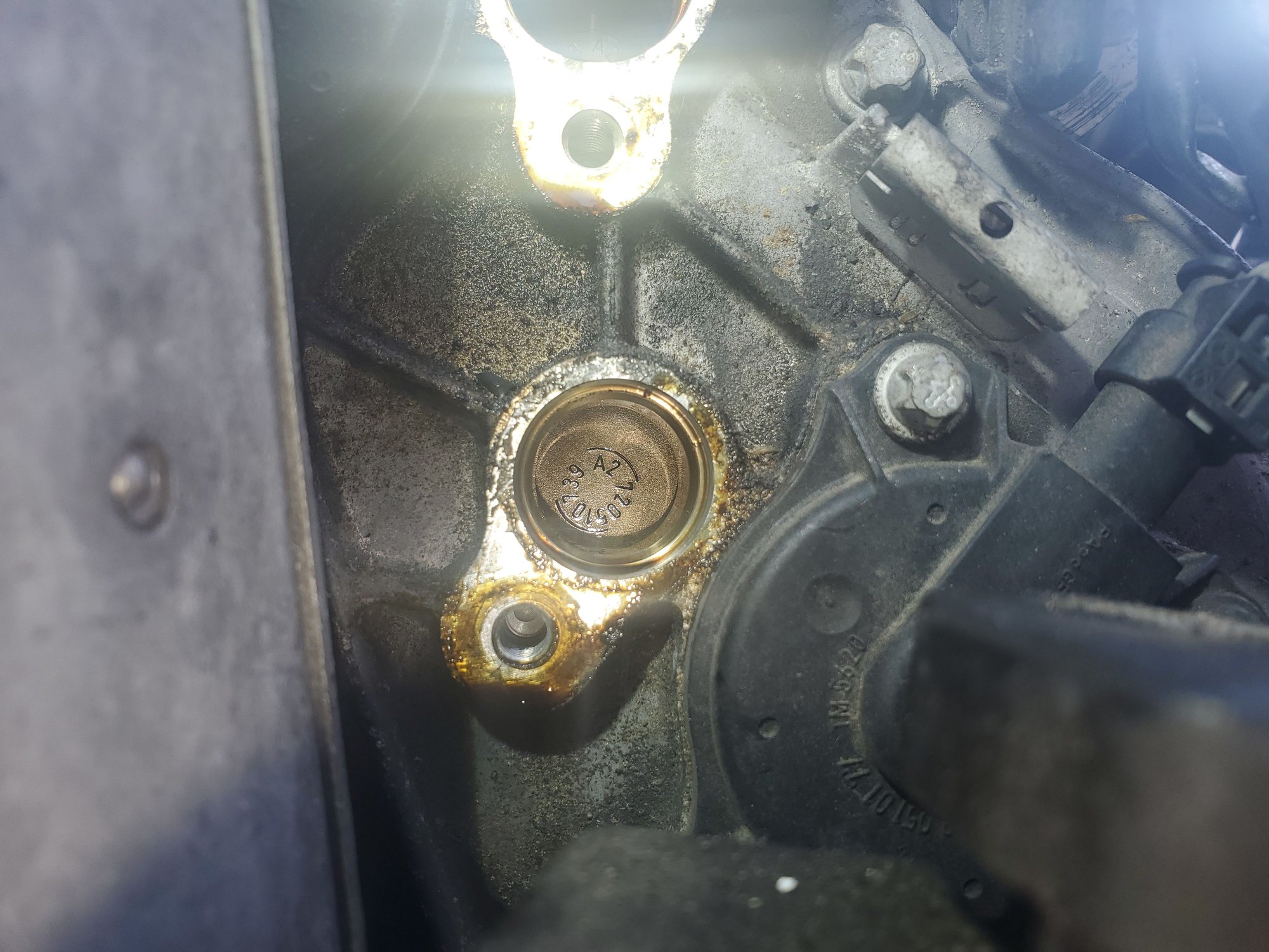

I checked the timing today. I don't have much experience with these cars. What do you guys think of these photos?
This is the crank at 305
Bank 1
Bank 2 intake cam
Bank 2 exhaust
