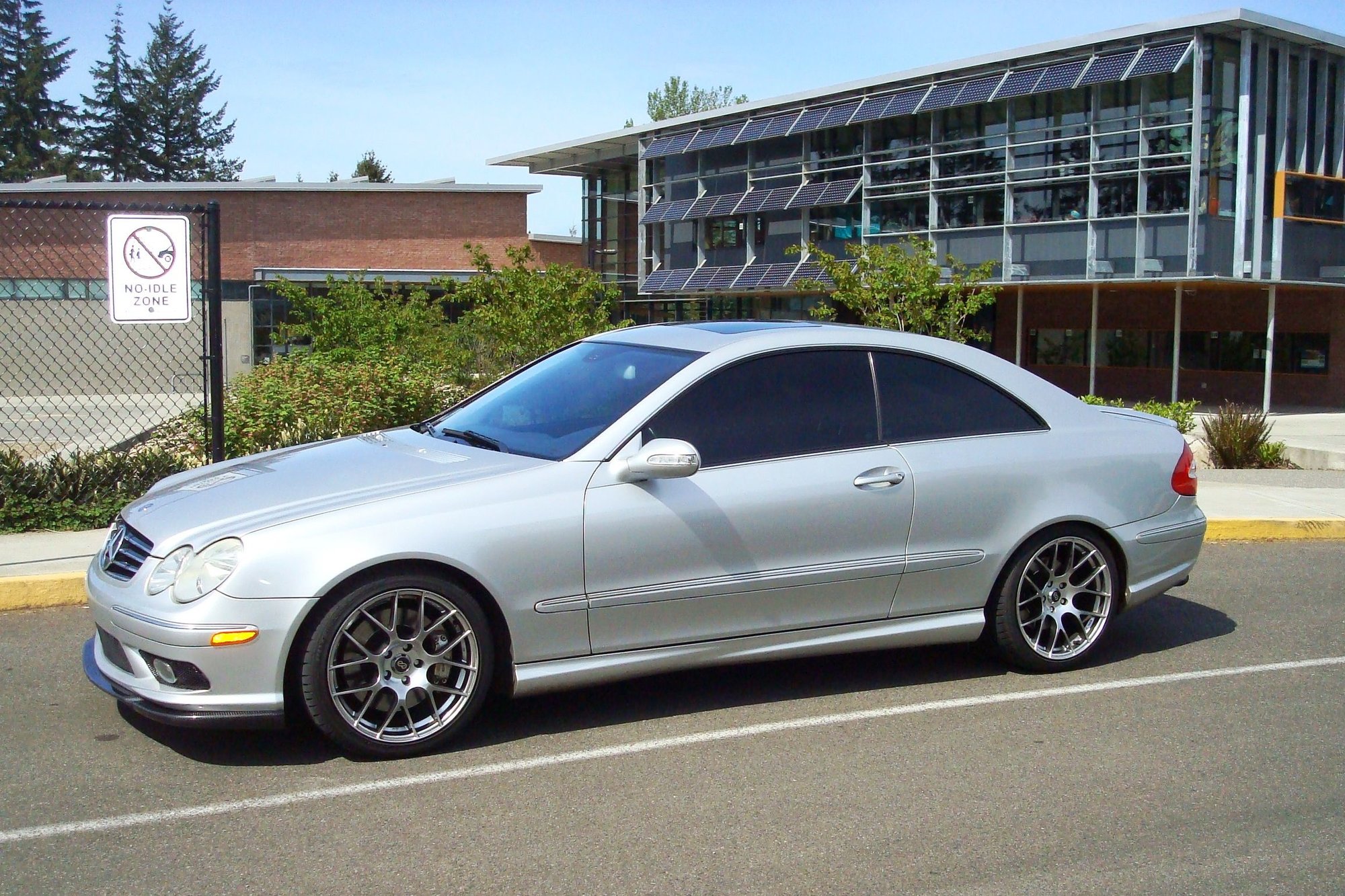

My 2003 CLK55 had the 17" twin five-spoke wheels as standard equipment. Eventually I went with all-season tires on them for when the weather got bad and aftermarket 18" with summer performance tires for the rest of the time.
If I recall correctly, early on the CLK55 was only available with the 17" wheels while the CLK500 had stock 17" and optional 18" wheels. I think I read that in a Road and Track comparison test of the CLK500 and BMW 645Ci, but could be mistaken.
