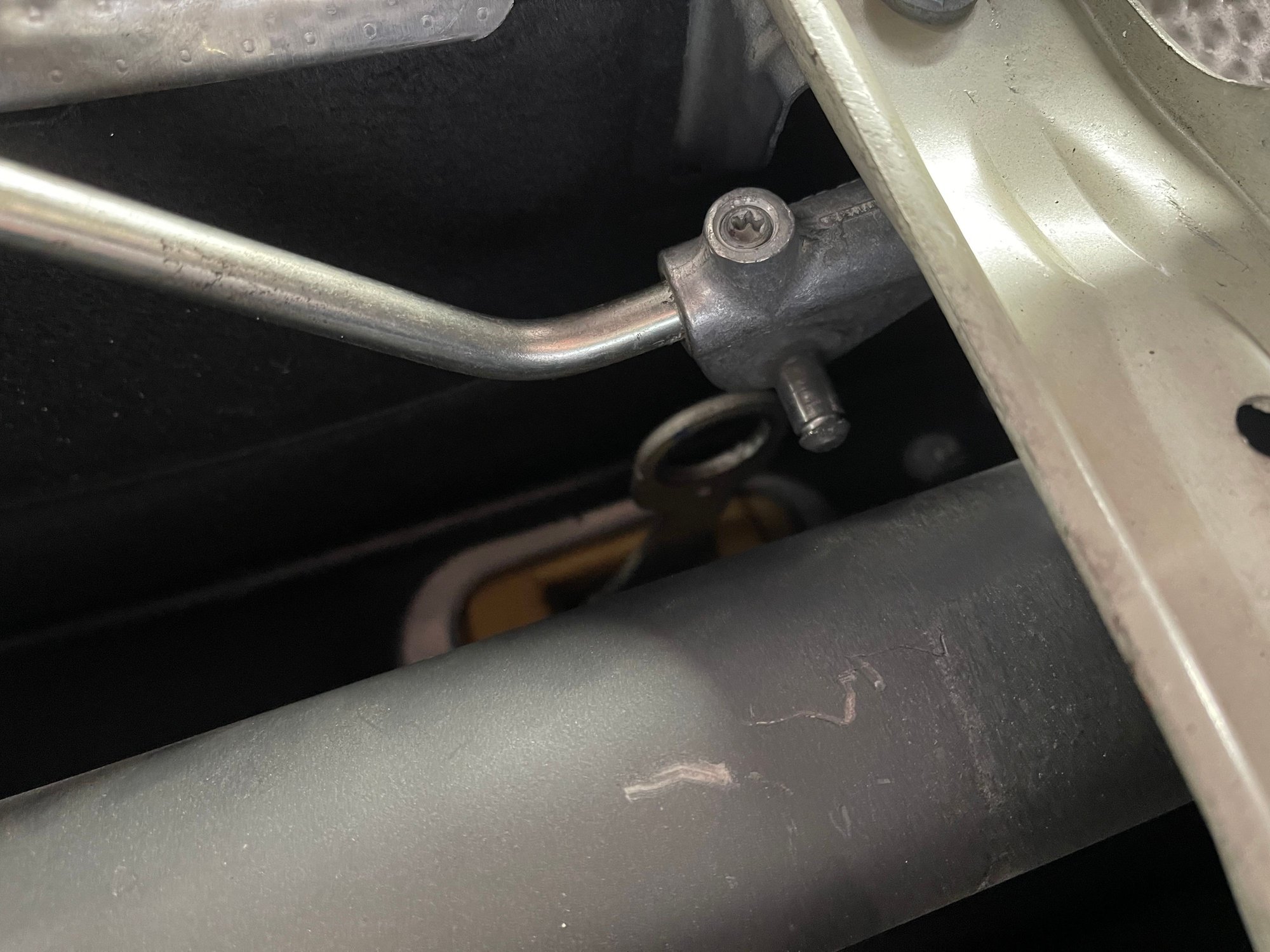

I got in my car tonight. Fired her up and go to shift. I hear a faint “boing” and suddenly the shifter is completely limp.
There have been no slippage or transmission issues since I have owned it. It has 90k on it. Any thoughts?
I don’t race it. I don’t drive hard. I baby it. The shifter has no positive shift feeling when changing gears as if a cable has come loose or something stupid broke off the shifter. When shifting the RPMs do not change and there is no engagement.
Any help is appreciated.

Figured it out. Needed a new clip on my shifter rod. Price was $4.01 at the dealership.
