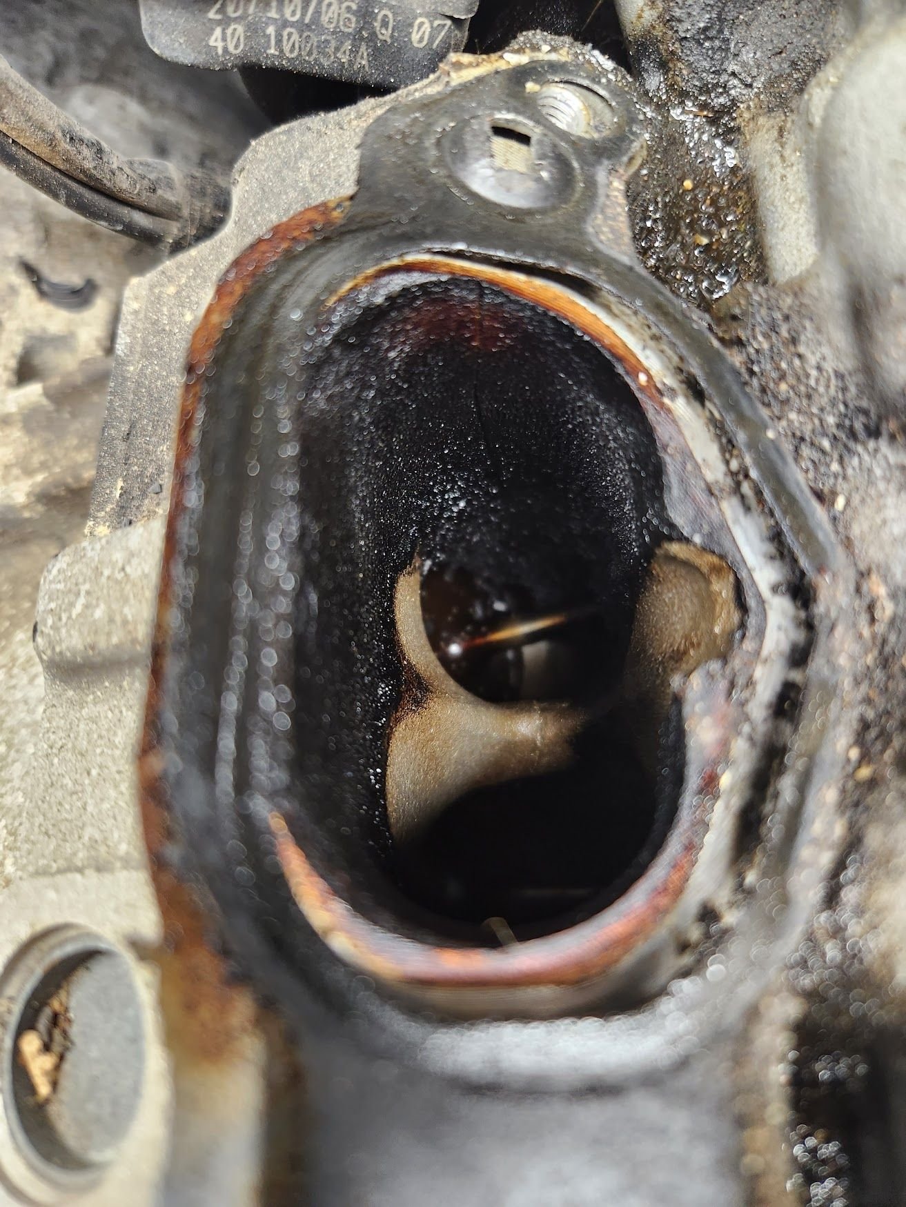

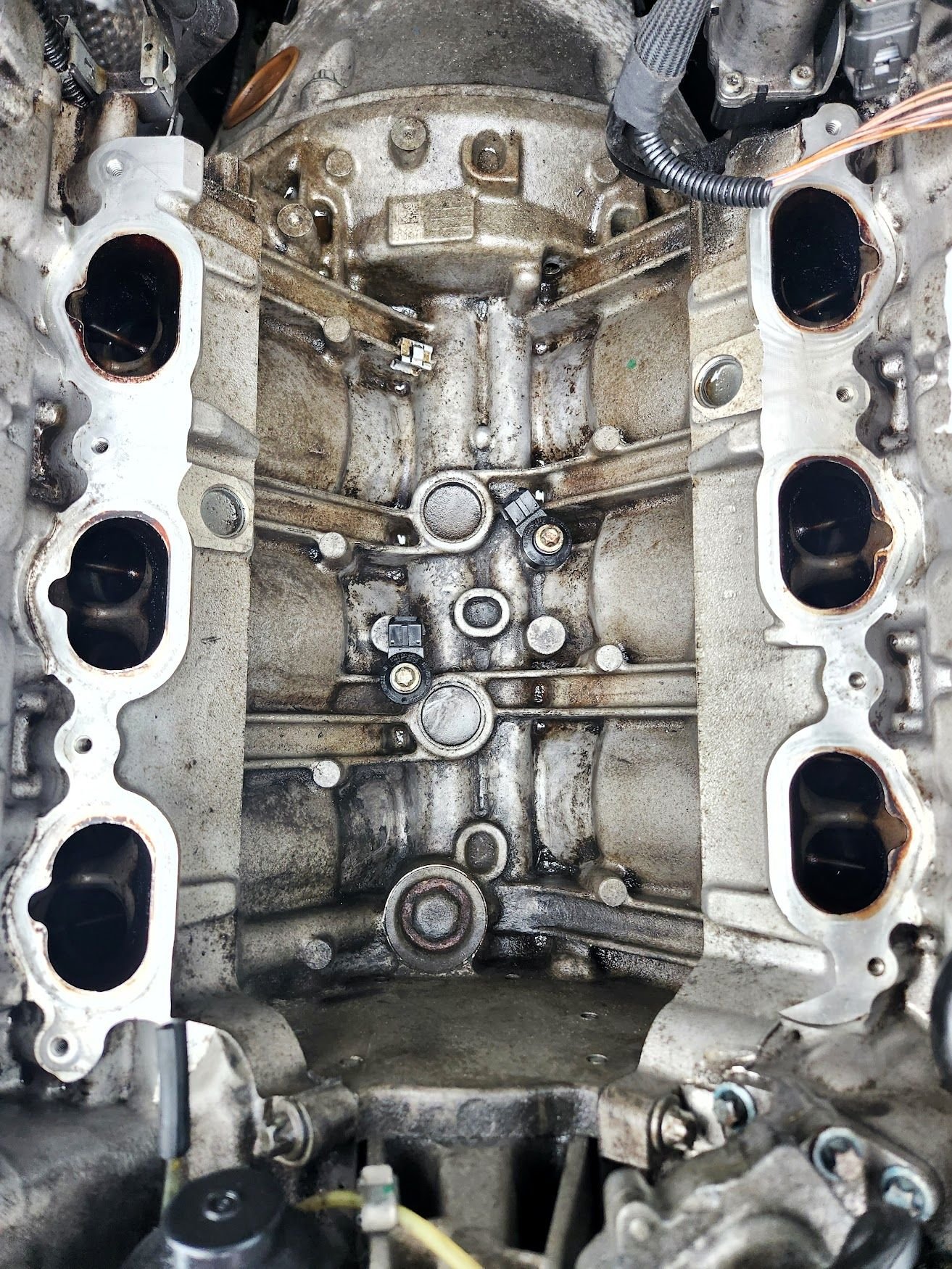

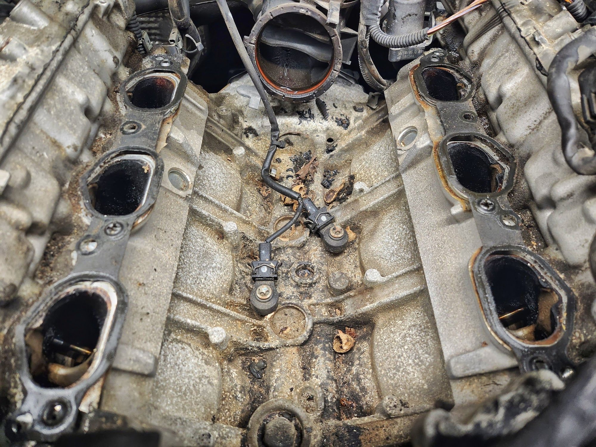

After removing the intake manifold, you can see how much dirt and debris is in the valley.
Valves were covered in carbon deposits

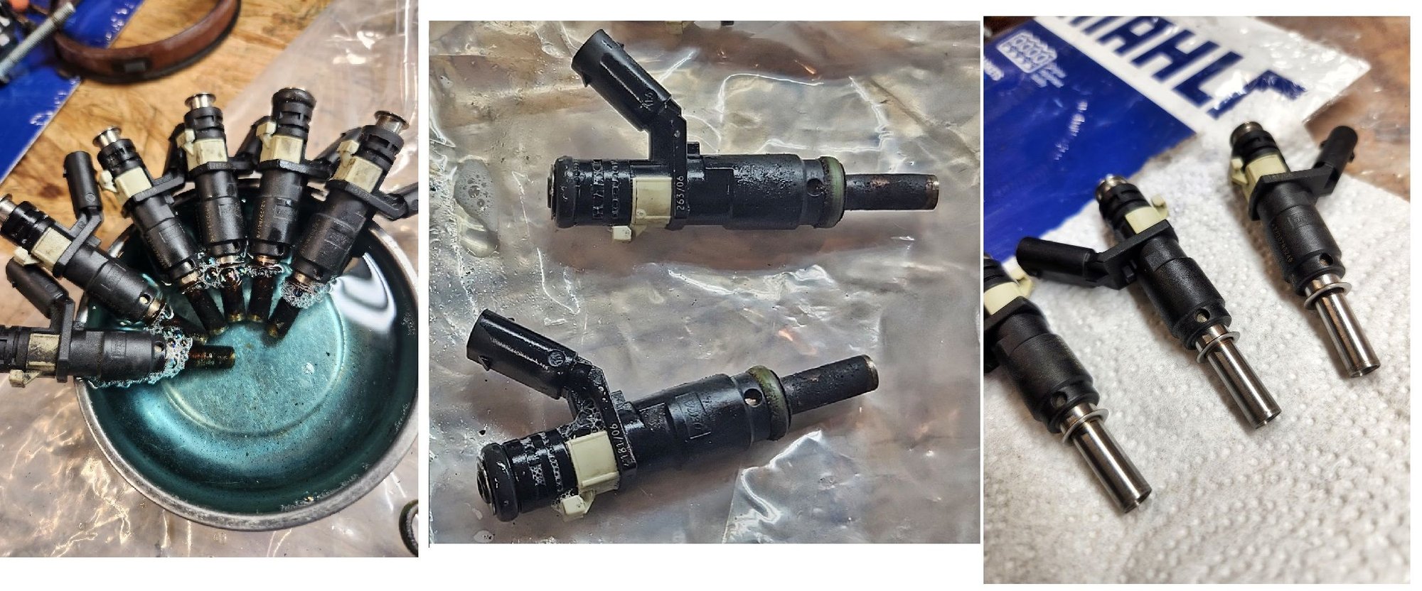

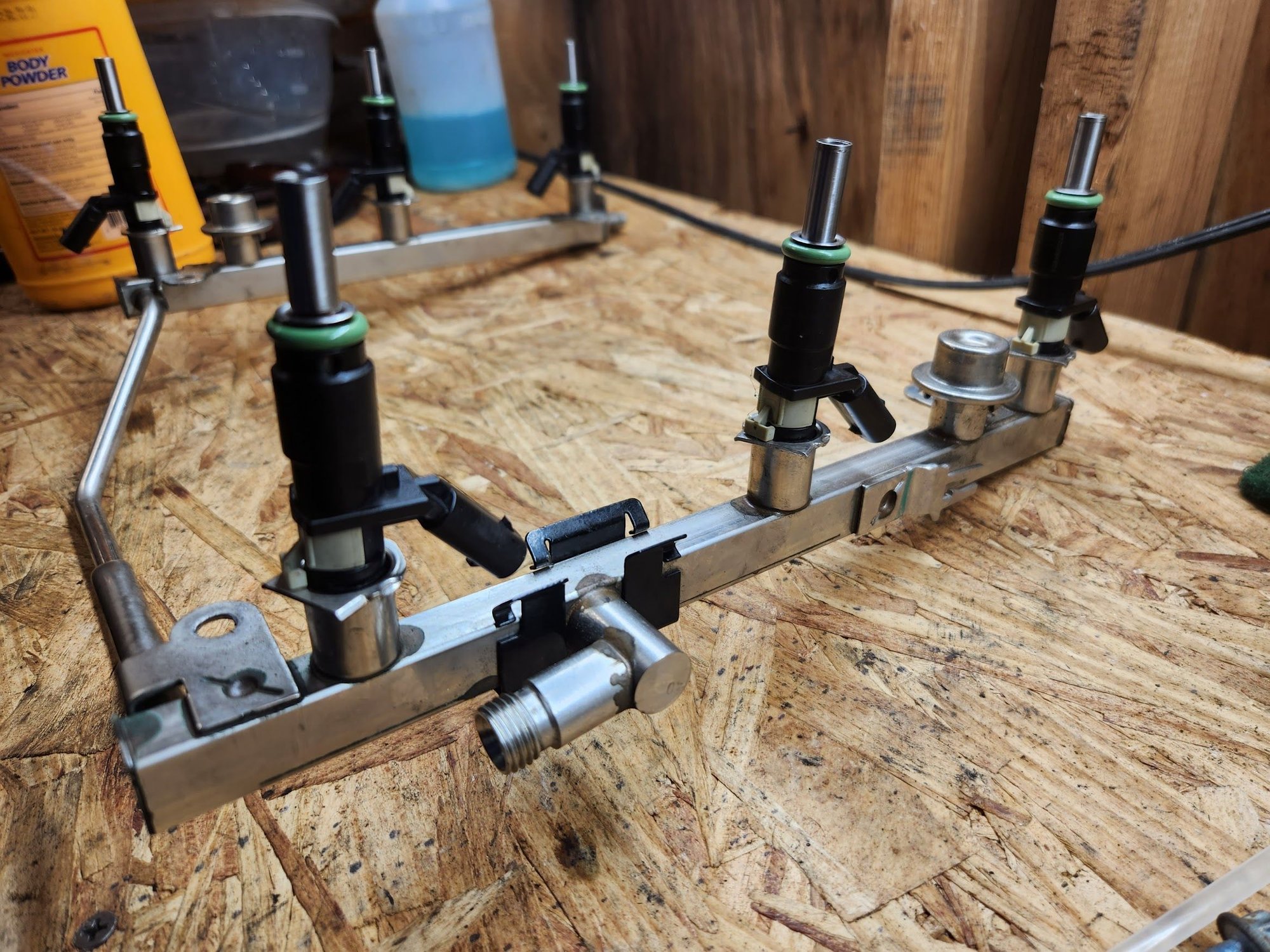

Cleaned up injectors best I could:

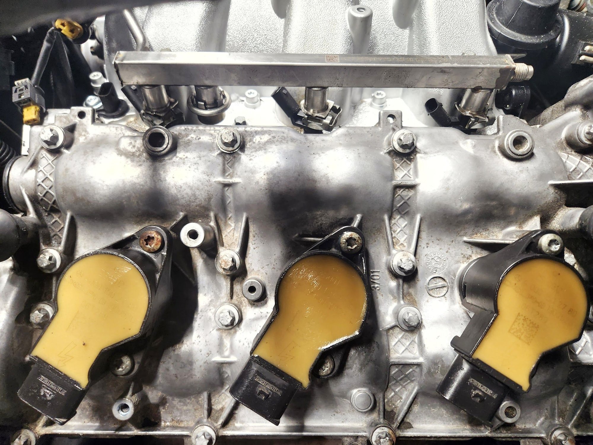

Clean fuel rail with new injector O-rings

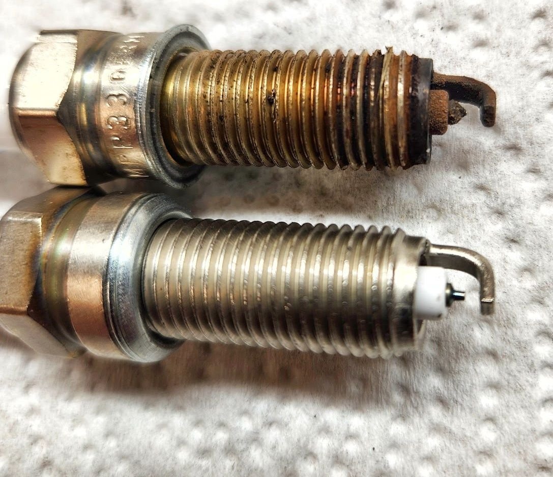

Old vs new spark plugs
New intake installed with engine cleaned up:

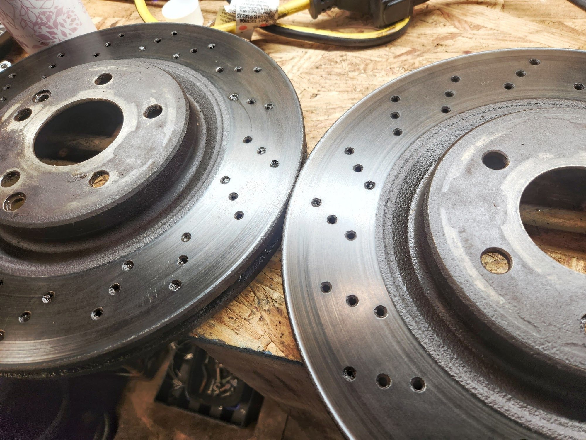

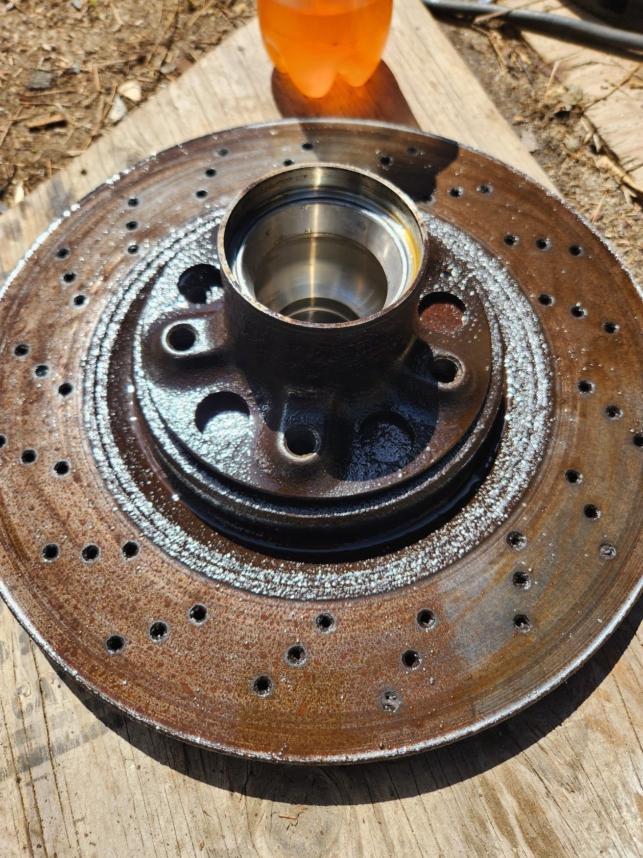

Old rusty rotor treated with Deep Creep:
Front rotors cleaned, with new bearings/race installed into hub.
