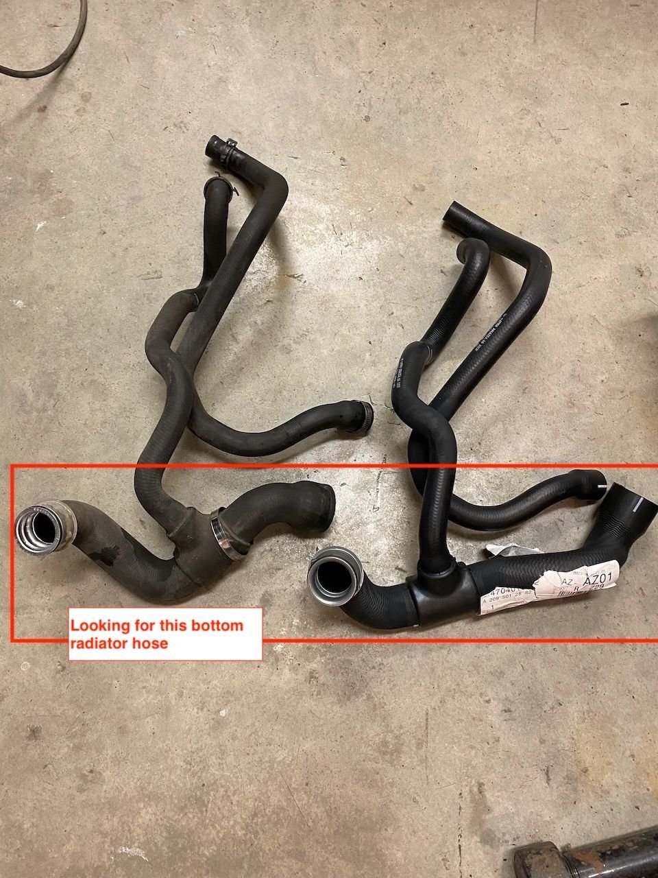

Everything was going well until I found out that the lower radiator hose I ordered was not right. I verified and yes, I got the part I ordered (fits the illustration), it looks right at first glance but the larger bottom hose has a different shape. I contacted my local MB dealer and they told me the right part for my car, serial number ending with 4T012726, is P/N 2095012982 which is no longer available. I asked what they would do if my car came in for service, he said "Nothing" !!??
Has this happened to anyone here? I looked at everywhere online and can't find this part number! Thanks!

It now looks like I got the wrong P/N from the dealership, I'm trying to find the right one. Here's a picture, the hose to the left is the one I'm looking for.

Thanks for replying MrChanlyn, the part I got was from Autohaus and didn't fit because of a Canadian / American car difference issue. The only difference only seems to be the angle at which the hose connects to the block, so maybe I could upgrade the connector. For now I found O-rings for the existing hose so I should be OK for a while...
