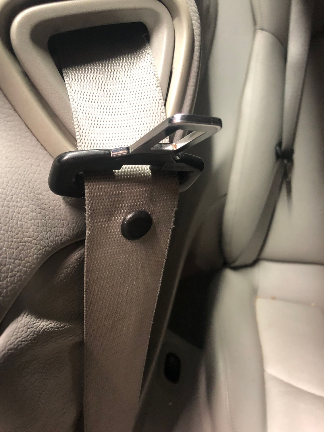

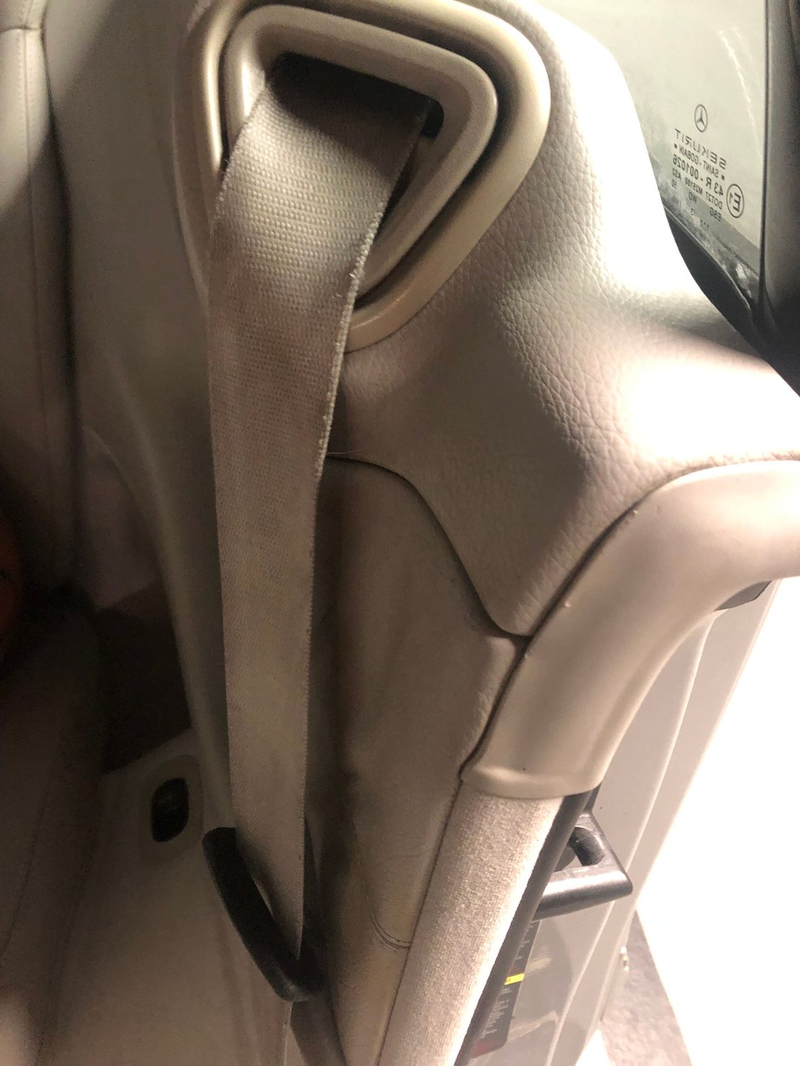

Let's talk seat belts, am I missing something here?
Below are my driver's side seat belt and my passenger side seat belt, both at rest. The passenger side has the black button that keeps the male part of the buckle from falling to the floor, but the driver's side has no such button. Am I missing something here? Could the driver's side have been installed backwards???

My CLK 350 came with the black buttons on both driver and passenger seatbelts. At some point this past summer I noticed the driver side button missing. I later found it under the seat while cleaning. My local auto parts store had replacements for a few cents. They are just a simple two piece plastic thing with a pin on one side and a hole on the other. The pin is pushed through the seatbelt fabric and the other side is snapped on. If you look very closely you might be able to see where the old one was pushed through.

Thank you. That's great information.
