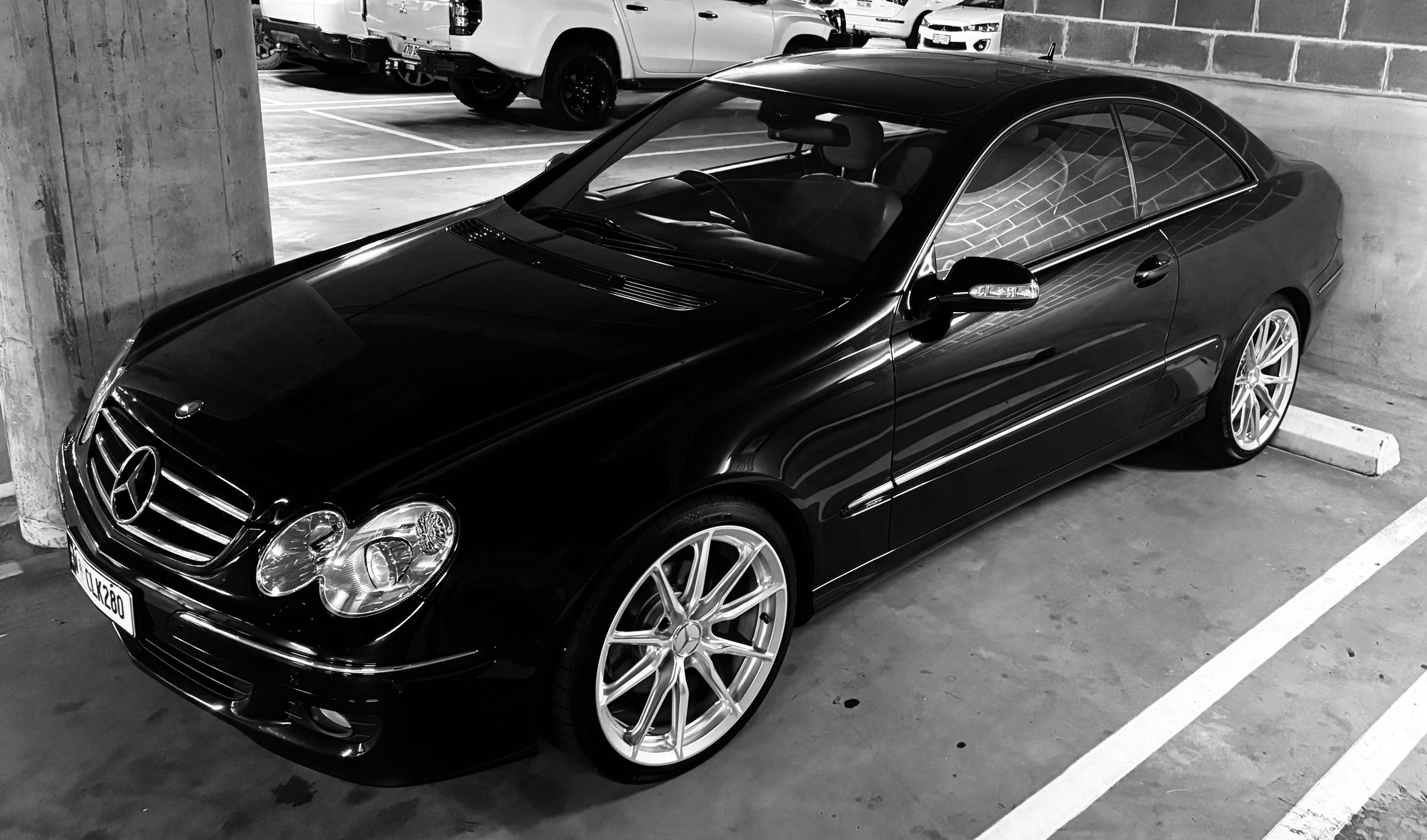

2007 CLK280 AMG Brake Caliper Upgrade
Hi Guys and happy Friday from down under, sunny Australia.
I have a CLK280 pictured here that is in excellent condition. As an engineer, I maintain my own cars so its serviced, checked and rechecked regularly and runs beautifully, save for the transmission which runs at its best when warmed up. Its a fine old Mercedes at 18-years of age.
I recently changed my brake rotors and pads to ATE / ATE ceramic - no issues there. I'm running 19" wheels which is the only change from stock thus far. I'd like to explore options for fitting AMG brake calipers all round and looking for any knowledge as to what AMG model calipers will bolt up. I've read CLK63 fronts and SLK55 R171 rears will fit however, could not find that thread among the 000's on this forum.

Henrick, I'm also in Australia (Syd) and have a 2007 CLK350. Sorry I don't have answers to your calipers query, but I was wondering about your wheels. Are these Bola CSRs? I was thinking of a similar upgrade (but 18" as befits an old bloke like me) and the Bola wheels looked attractive. Could you advise as to where you got them etc.? Thanks.

Hi Greg, thanks for your reply. Now how old is old :-). I’m a 1967 model and those 19” wheels are surprisingly comfortable. It’s a personal choice and the rubber you use will influence your ride dramatically.
I opted for a multi spoke, mono-block forged rim for strength and I’ve tested them on a great number of pot holes this winter. No issues at all. The wheel is HRE P104SC. 19x9.5, 19x8.5. Now before you look at the USD and price of those wheels (they’re worth more than our cars together), I had these wheels engineered and made up for the CLK. This included for 12mm bolts and radius bolt cups, to suit OEM specs. After market wheels are generic and both 18’s and 19’s are usually drilled for 14mm bolts and tapered bolt heads. One size fits all. I also had my wheel bolts made up by Honishen.
Happy to assist and give you some contacts. Forged = strength. Cast is also fine. It comes down to budget.

The CLK looks great. I like that colour too. A set of 19" would look very good indeed! Given your model, I'd retain the original wheels. I'll also be looking at replacing bushings, engine mounts etc soon. There's no issues yet, more a preventative maintenance approach (and I need to fiddle). The fuel pump is also meant to be replaced according to spec and I have a new one of those just waiting also. My thermostat also failed recently - stayed open and the engine could not reach operating temp. Now that was a simple replacement.
