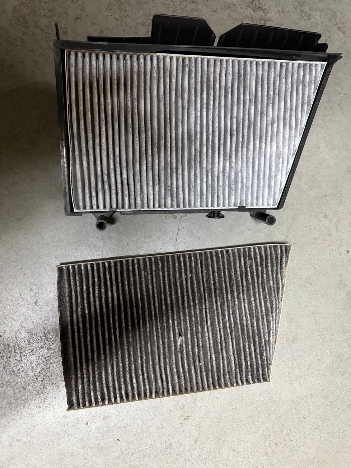

Changed it today. About 13 months and 13,000 km's almost all city driving in one of the dirtiest air pollution in Europe.
(New one on top in cradle)

that's the pollen filter above the battery in yhe engine compartment. The 2 cabin filters are beneath the glove box in the passenger footwell.
Thank you.
All of the DIY videos on Youtube refer to the one I replaced as the Cabin Air Filter.
I looked up the 2 charcoal filters you are referring to and it seems that not all cars are equipped with them. I will confirm this with the Mercedes dealership next time I am there. But from what I have read online they are only found in cars equipped with "'Thermotronic' control panel (as opposed to the 'Thermatic' controller)"
When I search the parts diagram with my VIN the filters do not show as installed on my car.
