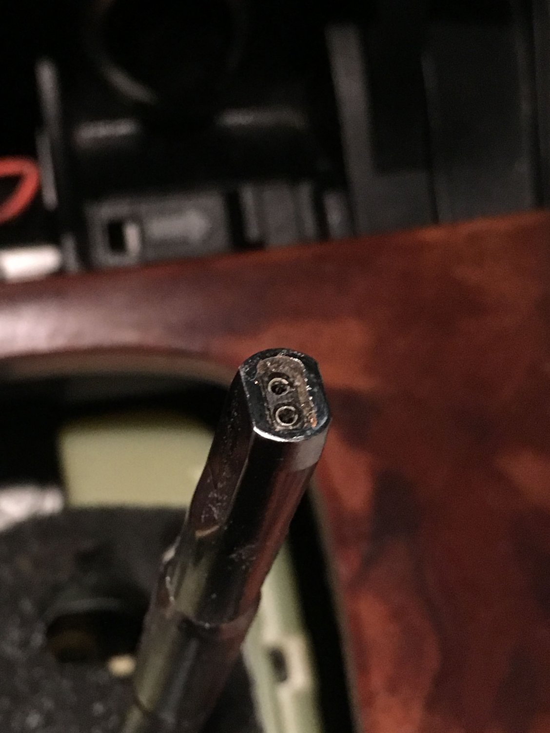

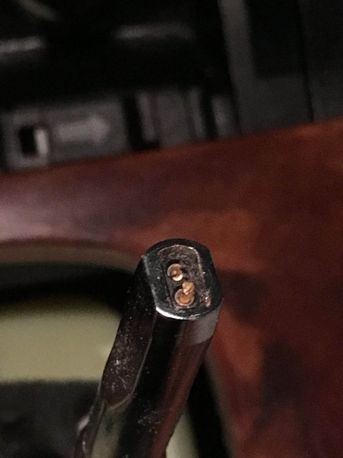

HERE IS WHERE YOU SEE IN MY PICTURE THE BROKEN OFF PINS INSIDE THE SHIFTER STEM
Boot and shifter removed with the wires disconnected
Shifter stem with broken pins inside
4. Remove the broken off pins from the shifter
Broken pins after removed from shifter stem
Shifter stem AFTER broken pins removed

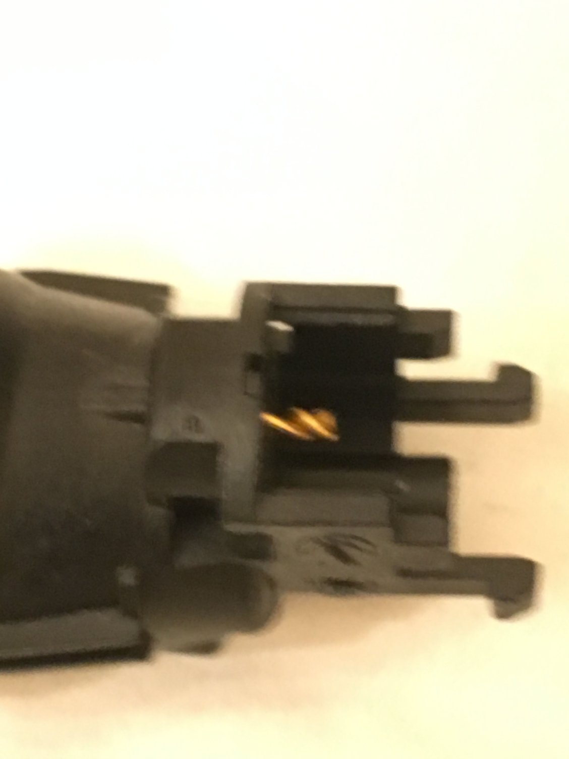

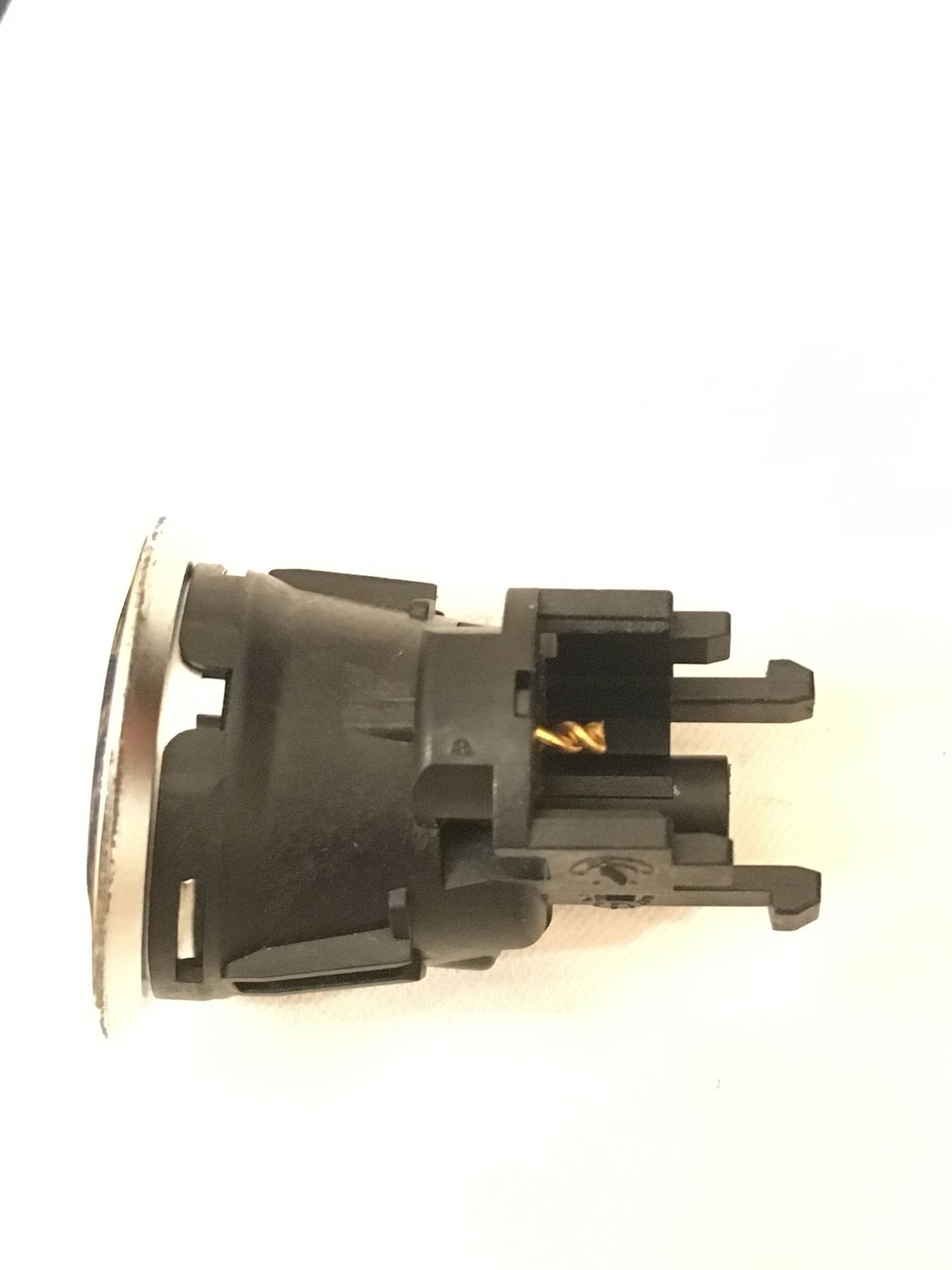

11. You will see the other half of the broken, twisted metal prongs. These need to be straighten and soldered back together and once they are, it should connect back into the shifter stem and work.
I am not done for tonight so hopefully will post more pictures when I solder and a video if I get it to work.

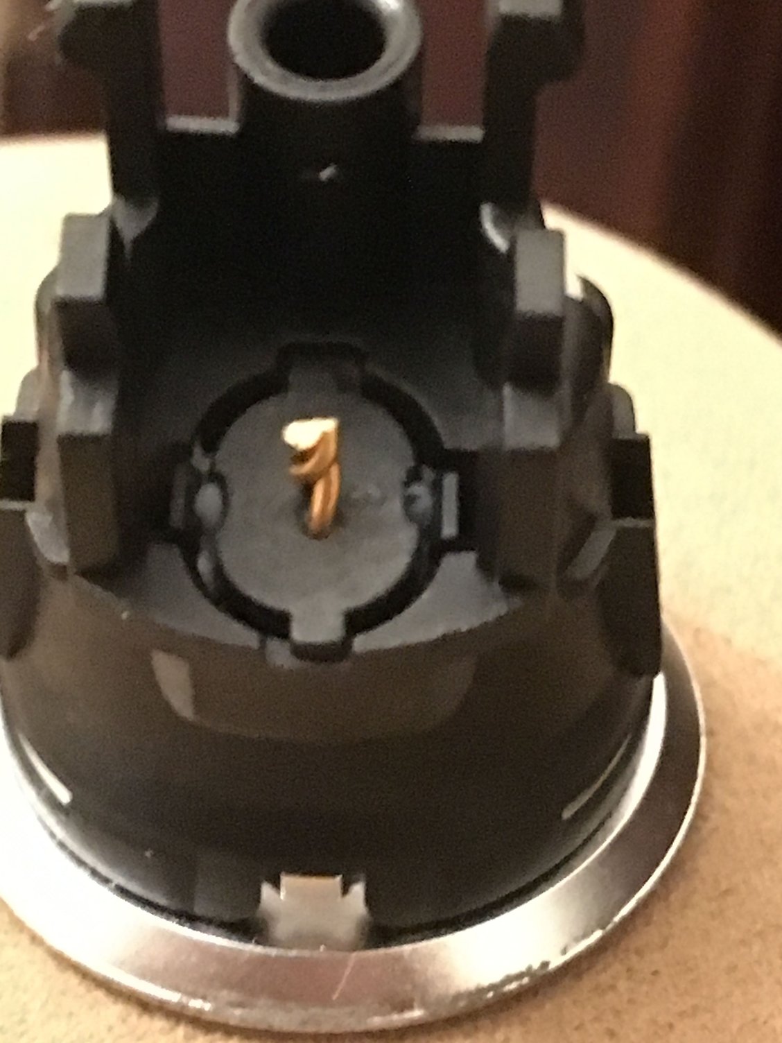

Twisted broken prong
Twisted brojen prong 2
Fully disassembled shifter knob
Top angle of twisted broken prongs
