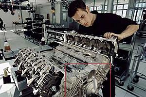

can you describe what a timing case is?
pretty much as the title describes ive been informed i need something called a timing case to make a e55 s/c swap work. can someone ddescribe what it looks like and its location?

The timing cover(case) is on the front of the engine. It has the water pump, belt tensioner, idler pulley, and crank pulley attached to it. It covers the timing chain and components.
Attached Thumbnails can you describe what a timing case is?-2005_mercedesbenz_amg_engine_assembly_inengine.jpg
