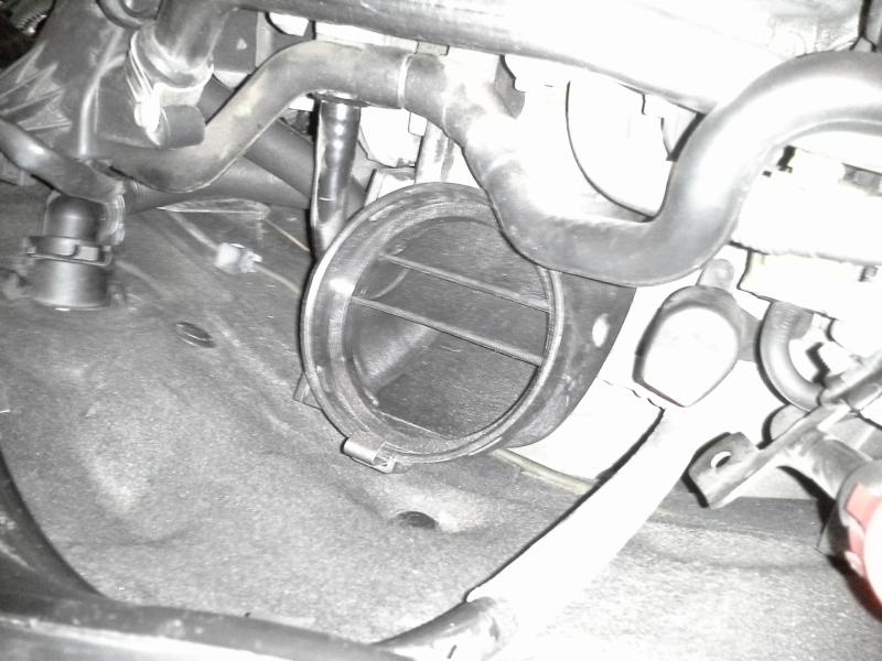

The throttle body is on the back of the motor, facing backwards. It's got this velocity stack thing that curls around from the MAF. How do you get that off? My TB is dirty as heck but I can't figure out how to get to it.

the black plastic has 2 clips that hook onto the throttle body. u have to squeeze them to the centre to release it.

sorted that one, got the TB out and cleaned it a bit better on idling i guess the ECU needs a bit of time to reprogram it isnt it?

I've tried that but I couldn't get it to go. Felt like I was going to break it. I'll give it another go...
