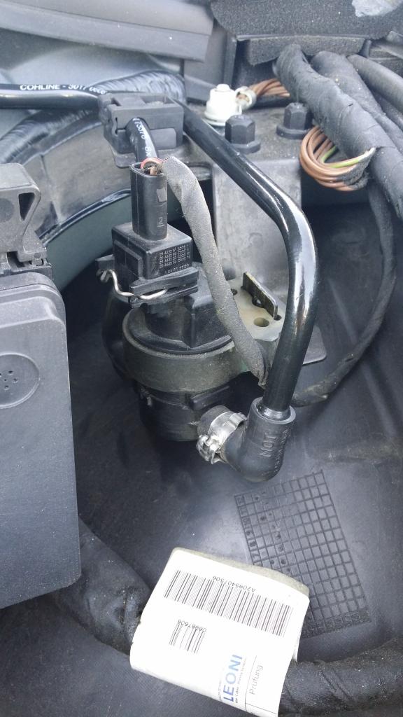

Also, what is this part? Looks like part of the ignition system. Its making a ticking noise as well.
