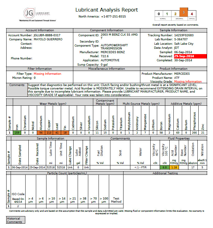

Well finally got my test done - and its got me a bit nervous ... although no antifreeze was found - they DID find high levels of metals -- maybe Rodney can chime in on this!
