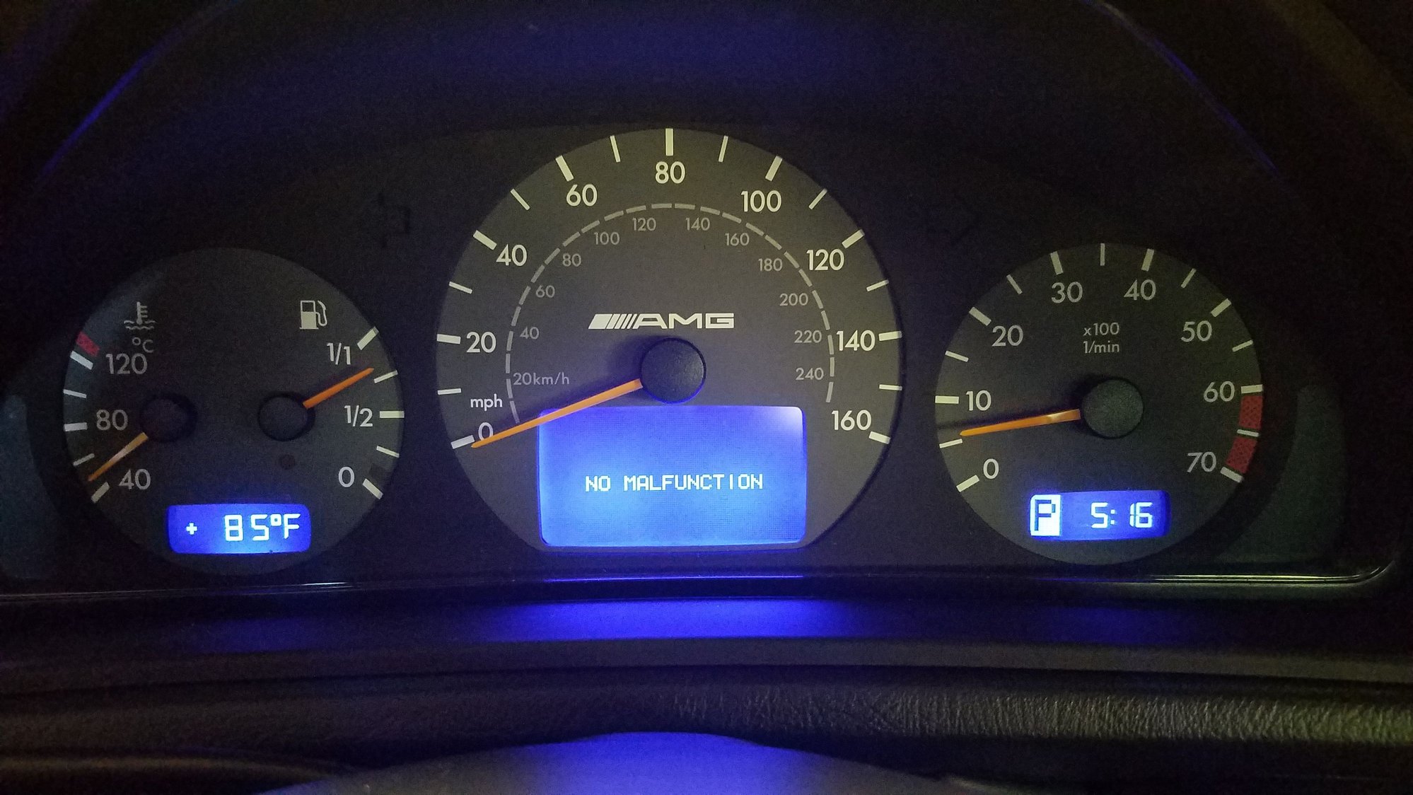

So i needed to replace the ribbon cables for my two side panel LCD displays so I figured I would change the lights as well. I bought the led lights off of ebay from Japan, took a while to get here and were not a very good fit. I had to file the contacts down with a dremel in order to get them to fit. Then I had to bend them in order to make good contact. After a little trail and error, I was able to get a good snug fit and here is the finished result. Fully functional and working LCD panels and blue back lighting. The LED lights were only $4.00 shipped but the hassle I had to go thru in order to get them to work was more work than I had anticipated.
