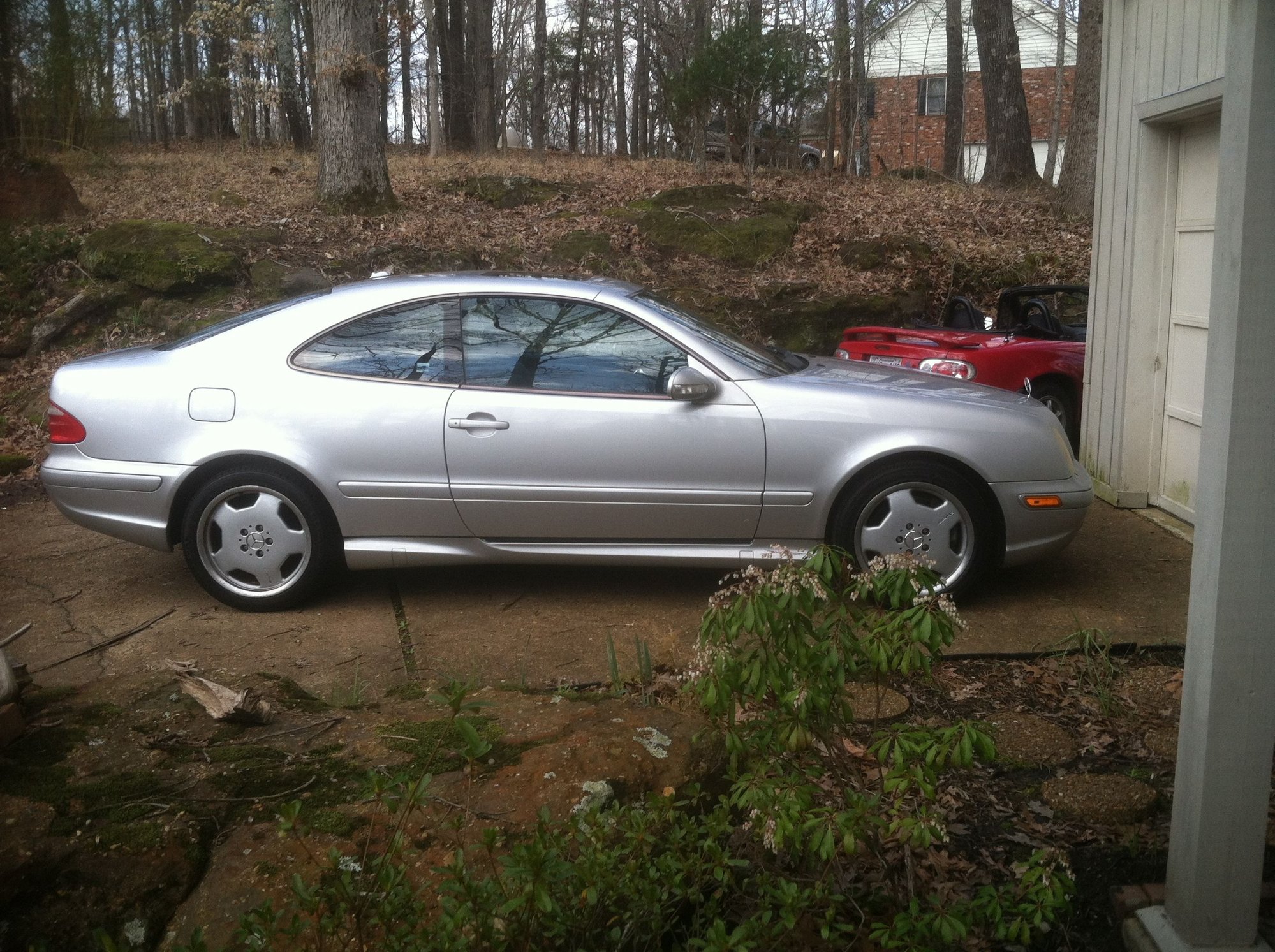

I'm planning to track my car at the local Porsche Club DE this June.Car is recent purchase-170k miles but feels very solid. Doing rear pads this weekend and will get an alignment before the DE (pulls right).
Have any of you tracked your cars before? How hot was it? How did your car handle it?
Temp gauge got above midrange in 70 degree the other day-will probably do a coolant flush soon as well.
