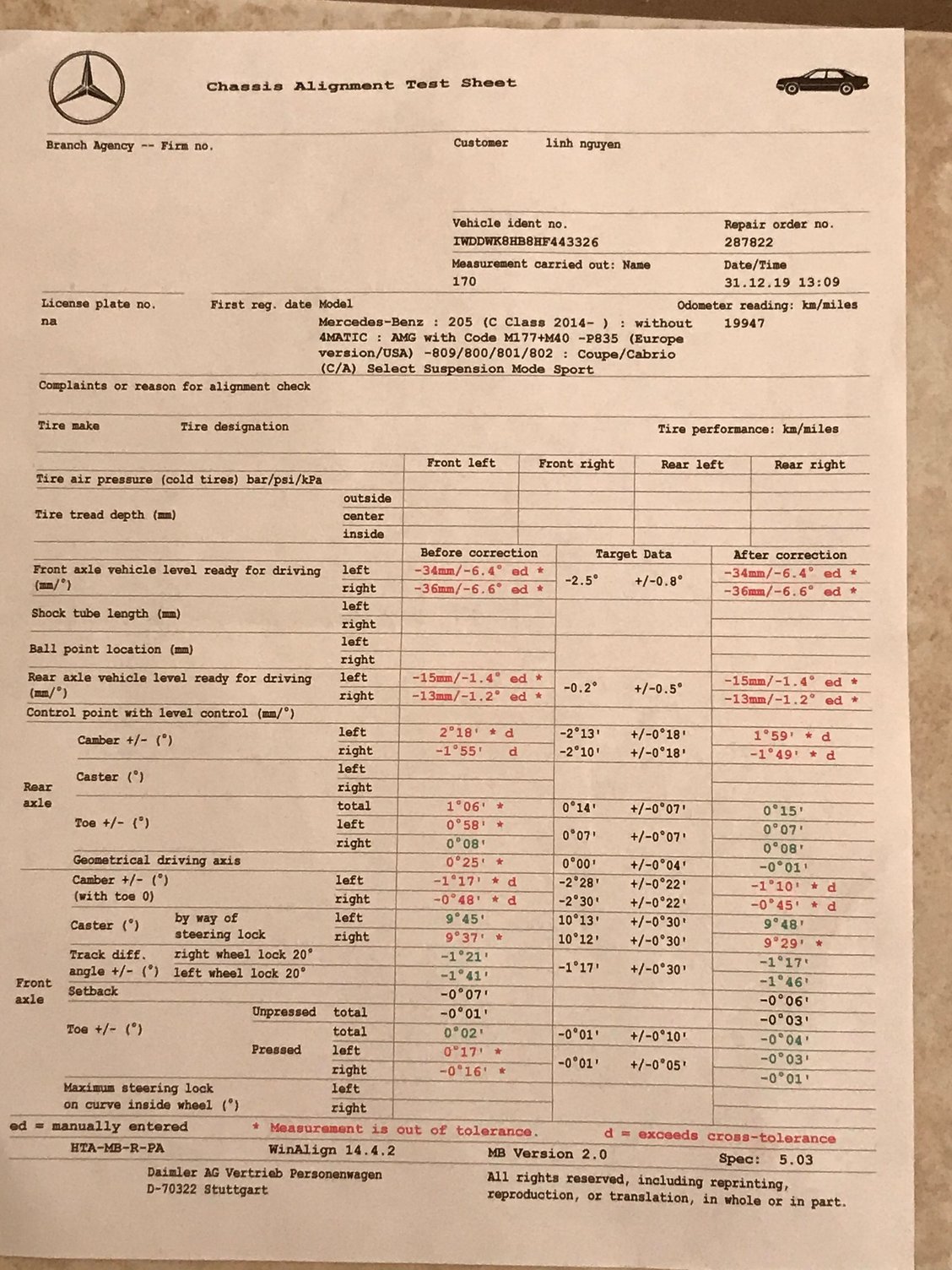

Looking for Mercedes mechanic help me to understand my front and rear camber. Glen, can you help me translate into degree. Thank you.

I just had my coupe aligned as well.
readings are in degrees. Calculated from 0.
The image is a bit distorted on cell phone but they provided readings.
I have a before and after print for personal mods I may need as well.
​normally they specs are given in range and veichle status before and after.
caster hopefully 1 degree of lead for road crown. Camber and toe near 0 for front.
I need to open that image up on a PC though. Haha

This is my print. To easily understand things in red need adjustment. Things in green are good.
From here I need to get a 1/4 to 1/2 degree positive camber in the rear. I could put a spring shim rubber in or rear camber bushing kit in. I'm doing the latter.
The front gets green with driver in car bit I'm a skiñy gator so I'm putting smaller spring shim in.
Tried printing the image and lost the color oh well.
I used a shop with Benz owner equipped with a floor level machine.
In other words no climbing up onto a rack all is in floor so no bumper damage or level change.
Cheers.
