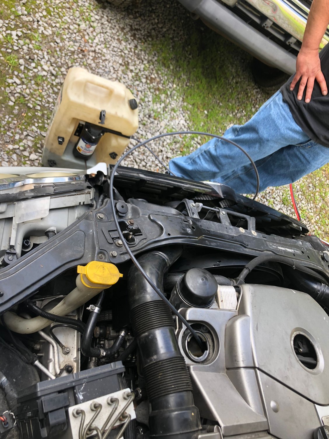

I have seemed to overfilled my clk 55 without a dipstick , I do have an oil drain machine 12 volt that can suck oil out through a dipstick , but there is none on this motor as we are aware of ,,, anyone know another option besides going under the car removing the shields and using the drain plugs ? Thinking maybe through the oil filter ??? Or maybe follow the Chain through the oil cap filler ?? Thanks it’s raining here for days and I need to get this done ... my lift is outside ..

I had the same issue, I removed oil through the hole where the dipstick is supposed to be, but as you mentioned there isnt a dipstick. Should be a red cap at the top left of the engine. Visible and easily accessible without removing engine cover etc.

I think red cap is transmission no? I don’t remember but this worked ! I followed the chain down ...

you are right it is the one to the left of the red cap tube if you are standing in front of the car. I use the because it hits the lowest part of the pan.
