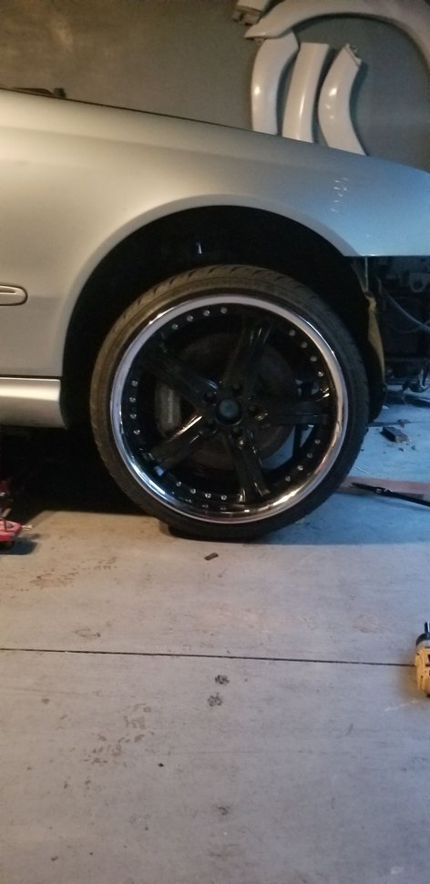

So here is how it sits.
Would a 205/30 or 195/30 with a 10mm spacer, do the trick? Currently the tire is 225/35.

If you have room for a spacer do that. If your tires circumference is to different front to back you will have issues. the good thing is that perch is static to the tires so the gap wont change with driving. (side note) I bet you money the car will feel slower with those wheels on it. look up un-sprung weight and rotational mass.

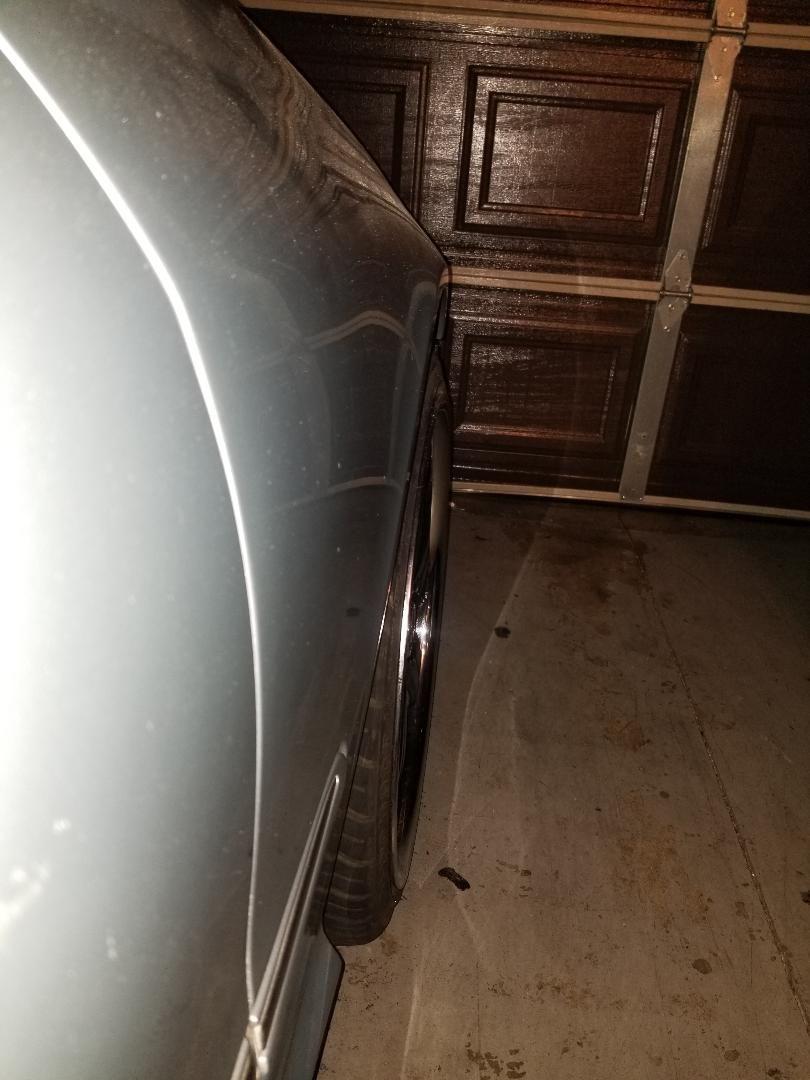

I’m surprised the rim is in contact with the spring perch considering how far out that offset should put the rim. A 10mm spacer would do the trick but that has to put the rim out from the fender? Do you have a straight on shot looking at the rim vs fender? Typical offset for an 8.5 rim width should be around 28 to 32mm. I wouldn’t go 205mm on the 8.5 rim, too stretched; but 225/30 would help a bit, maybe just enough. You shouldn’t need a spacer in the back though the a 275/30 is more typical. Are you rubbing the outside fender liner here?

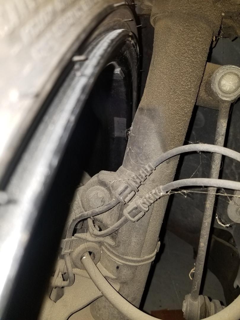

Bmo. i was thinking this.... since the spring perch seems to be the only concern, couldnt i change the front setup with coilover suspension kit which doesnt have the large spring brace. That should eliminate that concern for clearance as well as allow me to lower the front end.
Old May 5, 2020 | 11:43 AM
CLKAMG500's Avatar
Joined: Sep 2019
Posts: 66
2005 clk500 amg
strut tower behind wheel.
This is the look and space behind the wheel.. it seems as though adding a coilover eliminates the interference of the lower strut brace cup as well as not having to add a 10mm spacer. your thoughts?
