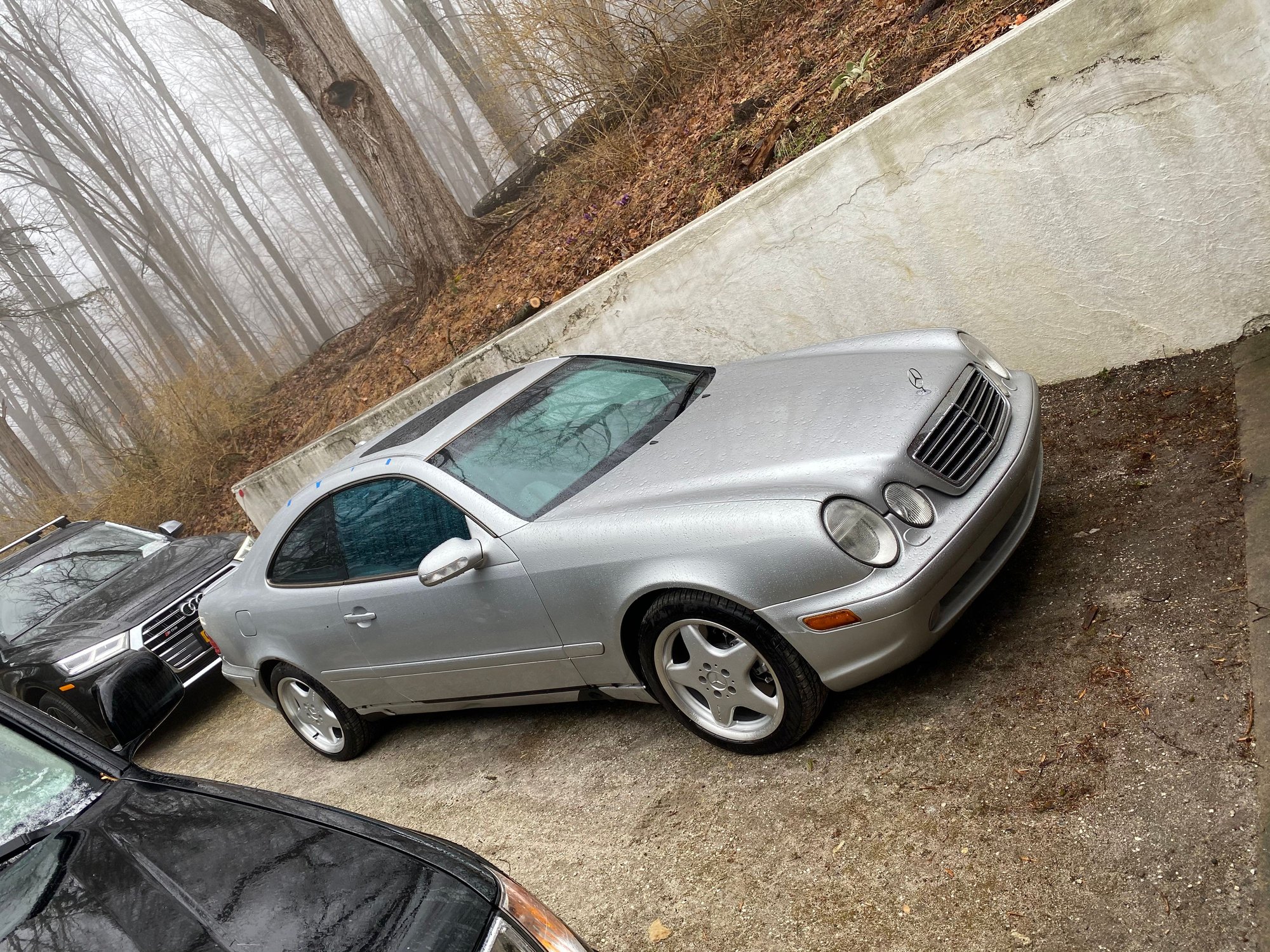

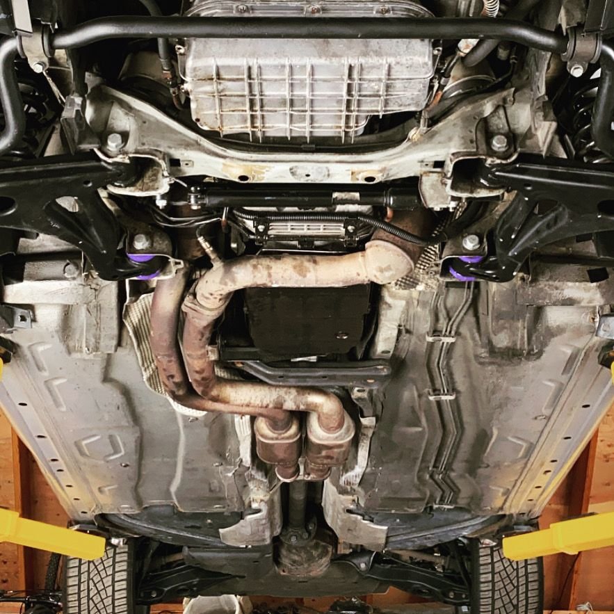

As usual I write a whole long write up and this forum loses it for some reason. 😕
182,6xx
all bushings underneath done lemfoerder rear, power flex upfront and genuine drag link and she sits. Like a new Benz or car would. Smooth like butter squat off the line hooks and she's gone. think we did all sway bar bushings Benz maybe a couple febi. Duralast rear sway links ftw
Managed to get the alignment very close, will try to do that myself.
front driver high beam out hopefully something simple.
noticeable play in steering box I would say. Must just be typical mileage for these cars. Torquing bolts might help. But adjustment or replacement is probably best bet.
check ur jack points for rust my biggest suggestion. Saved my drive front from probable replacement in the future I hope.
tranmission and diff service hopefully in the near future and all new diff all together.
rattle canned the front bumper and waiting 3 weeks for side skirt and roof trim clips from Ecs tuning. All new splash shields upfront!

Looks clean for the age. The lift makes a world of difference when servicing.
Keep it up
