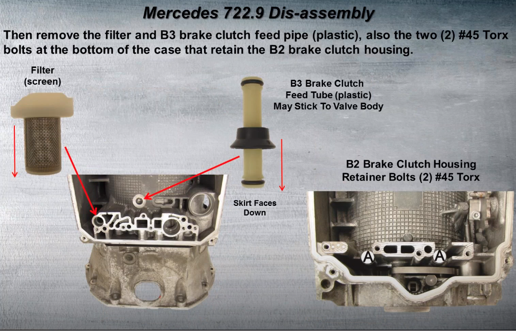

Hi guys :-)
I have a 2005 A209 clk500.
So Ive been digging around in my transmission and I found this filter in a bent/damaged shape and after an attempt at installation broken as well :-)
http://www.linesoon.com/index.php?un...t=2442&id=2443
The guys at mercedes ended up getting me the wrong thing, and I dont think they know what this is.
Can someone please help me with the part number for this?
When putting the valve body back, this screen filter keeps falling out making it hard feeling comfortable that things are back in right.
How do you get the screen filter to stay in that little hole when closing it up? Is it a stick with oil and hope you time it right thing?
Doesnt feel right to me :-P
Any advice would be appreciated.

This is under V/B filter,
MB part #: "A 140 270 01 98"..

You are my hero :-)
Thank you very much. I'll get 2 then I'll learn to do it right hehe.
