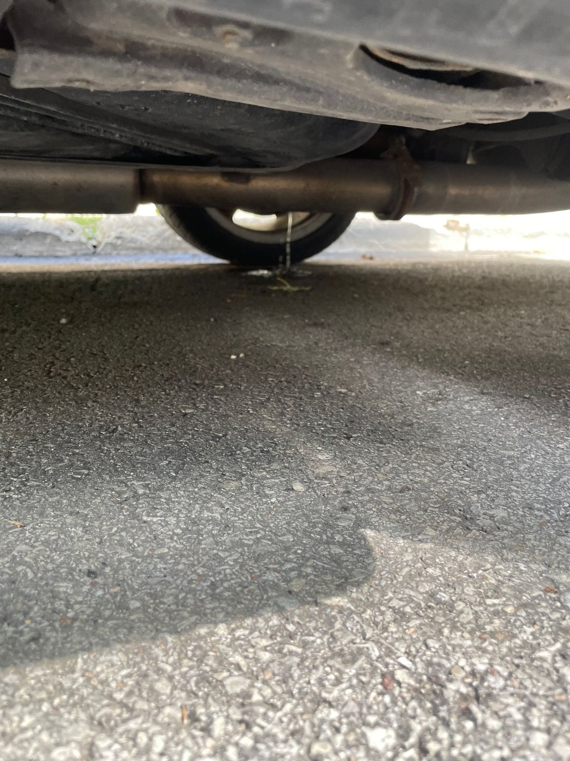

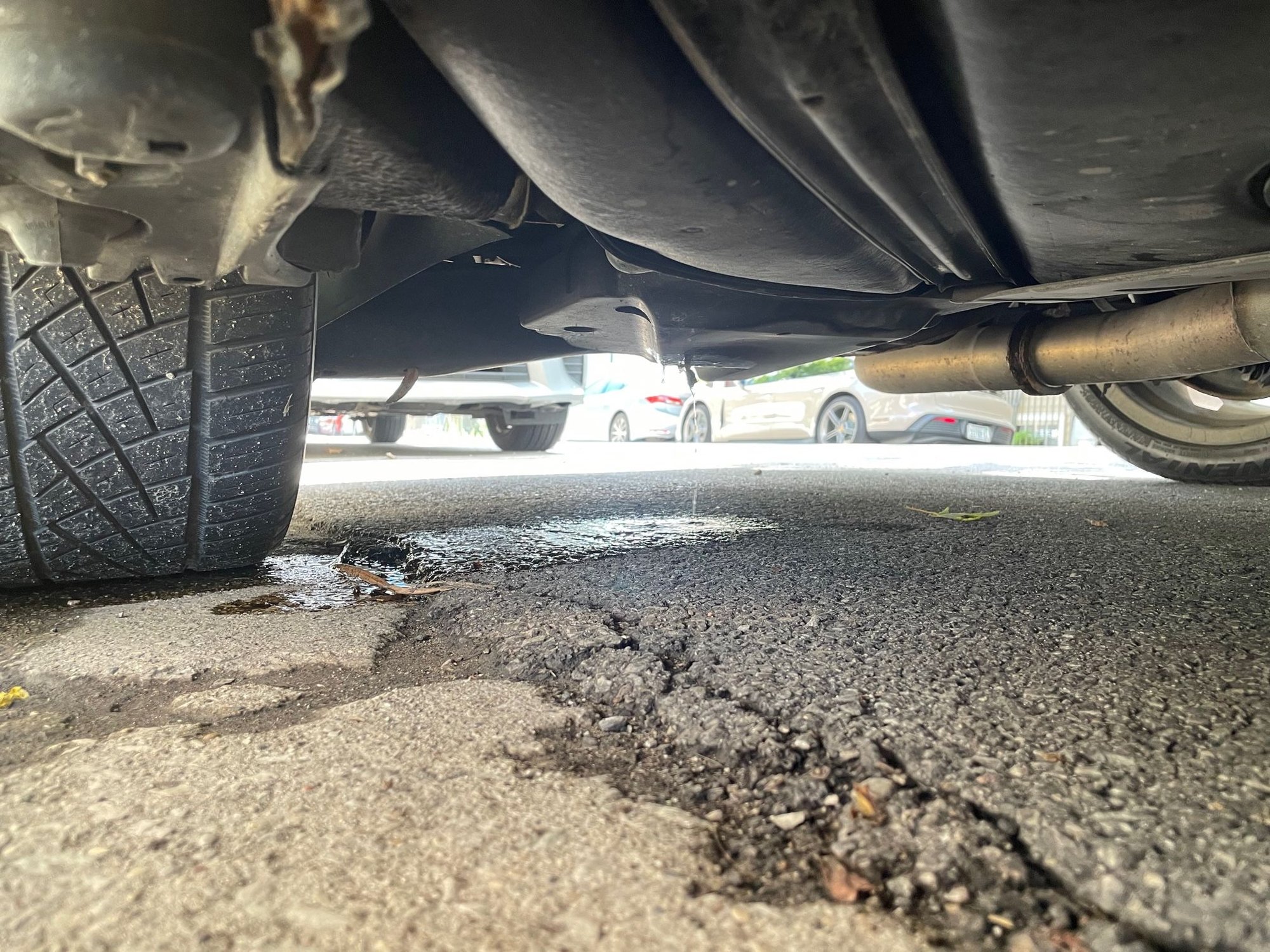

Well, I found the leak. Gas is pouring our pretty bad. It was not this bad so I think something got worse in the last couple days. I drove it yesterday and could smell the gas and after parking I noticed a trail of liquid behind the car. It was gas. I just started it up and took some pics and a video. Not good. I don't know what it is but it's on the passenger side rear,. Maybe it is line or hose that goes to the fuel pump on the drivers side. My indy is 20 miles away and my dad has a lift at his house but that is 30 miles away. I am not sure driving that far and on the highway is a good idea with this much gas leaking out. Any thoughts on what might be leaking? I am thinking of towing to my indy. I live in the city and park on the street so its tricky for me to jack it up and investigate.
Here is a video and pics.

Remove that black plastic cover that shields the fuel pump and filter. It is most likely a rotten hose. It will be easy to diagnose with that cover removed. (I think it's held on by three 10-mm plastic nuts)
Thanks @JoeJErnst . Do you think driving the car is a bad idea with this leak?

Yes, driving it like that would be a horrible idea. It looks like you are about to have the entire tank of gas on the road, so I'd fix it where it sits if possible. If you do have to drive, don't go far enough to get the exhaust hot.

Just wanted to report that my issue was a bad hose / hose clamp. $172 later I am all good
