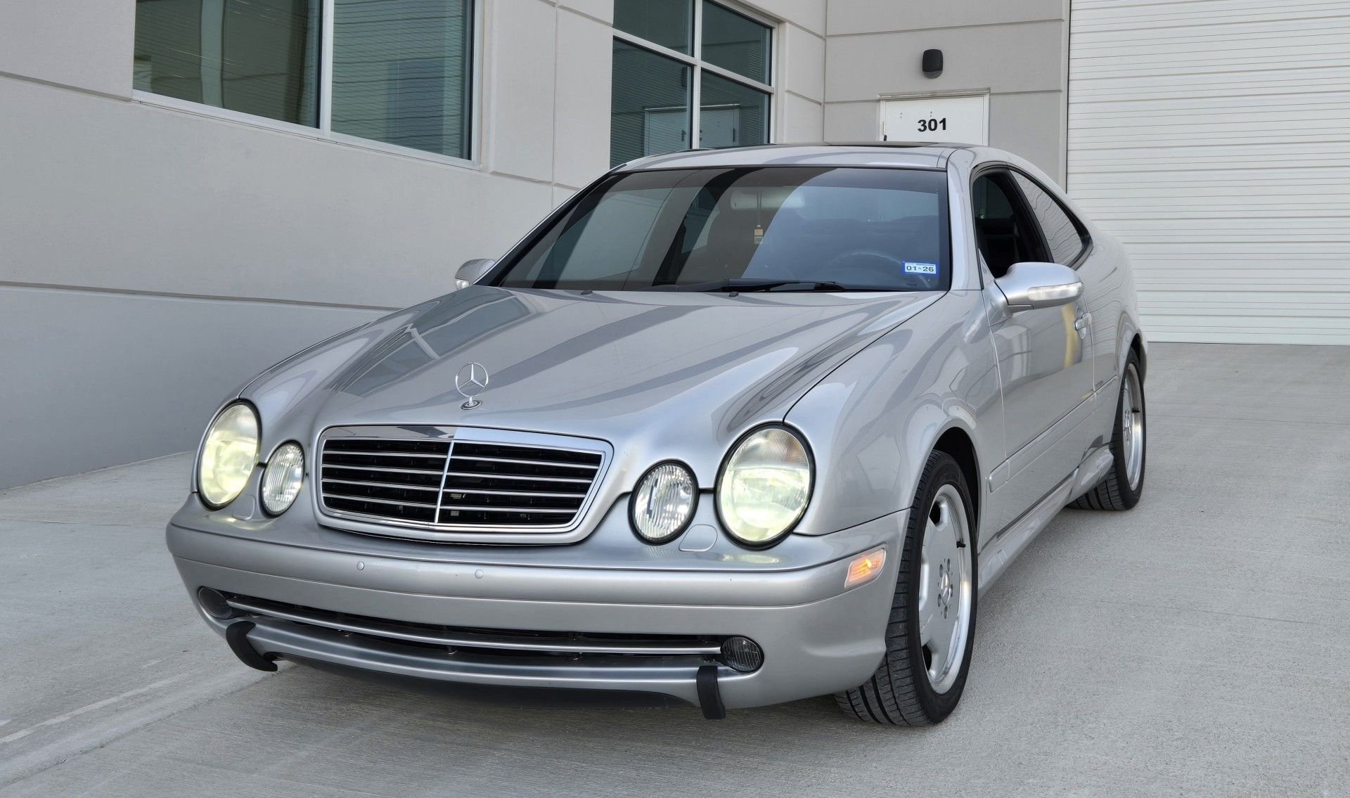

I have searched and come up with mixed results. I have a 2002 CLK55.
Can I ask those with 18's on their car to post up real world numbers with their wheels, offsets, and tire sizes?
I am most likely going to order off of the internet and only have one shot to do so.
I am thinking 18x8.5 front and 18x9.5 rear, but want the wheels to be flush with the fenders and not utilize spacers preferably.
Thanks in advance,
John

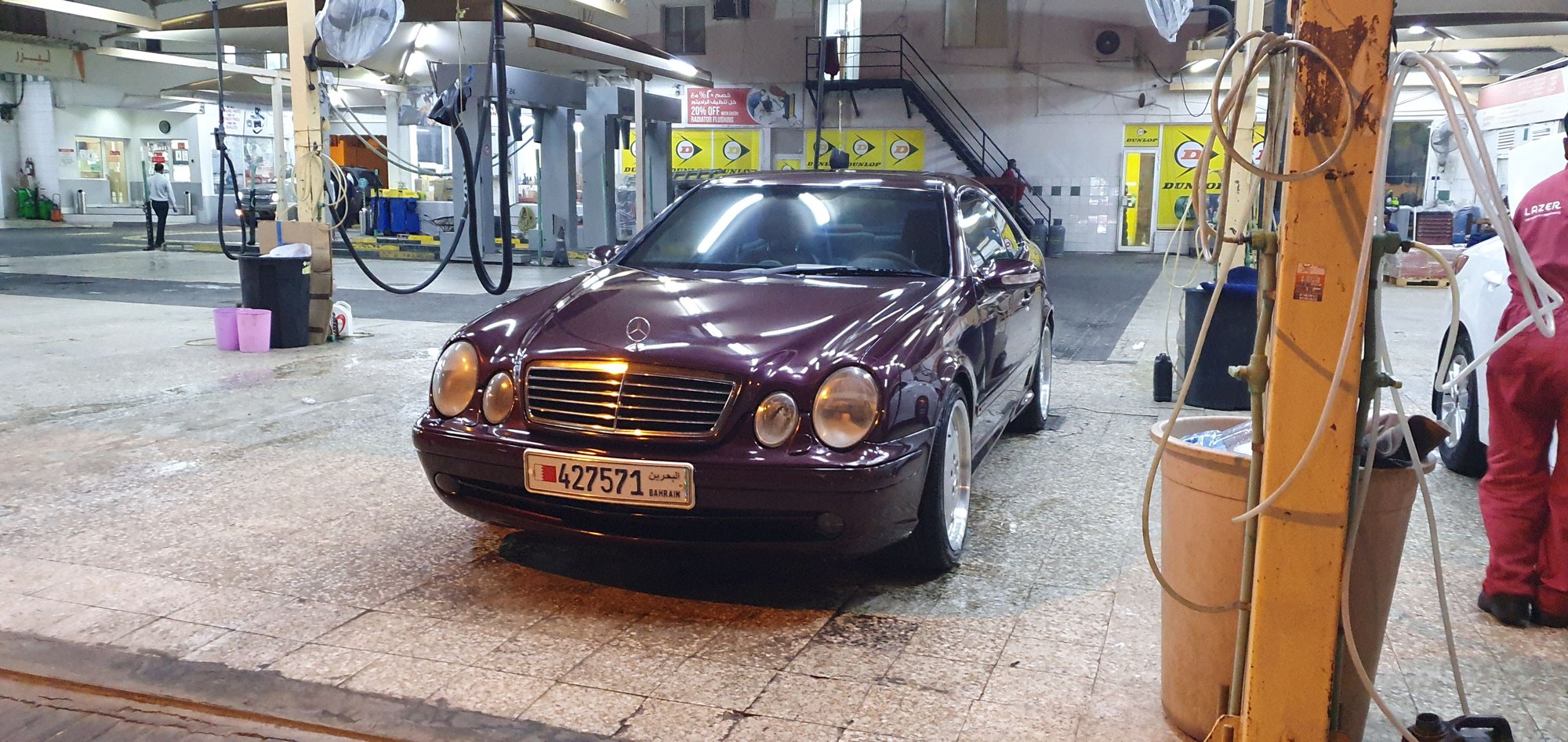

Based on your wheel specs you mentioned, I would assume you are looking at installing AMG Monoblock Type 2 wheels?
I ordered mine from the factory with optional Monoblocks and this is how the car looked. I didn't like the rear offsets so I installed 12mm spacers on the rears only.

I then upgraded to AMG SL Split Wheels by BBS and required to no spacers. Offsets were spot on @ ET25 front and rear.

Are those 17's in the first pic or 18's?
John
John
18" Monoblock Type 2
Front: 8" ET31
Rear: 9" ET35
