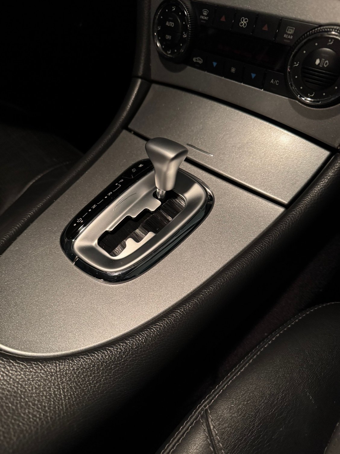

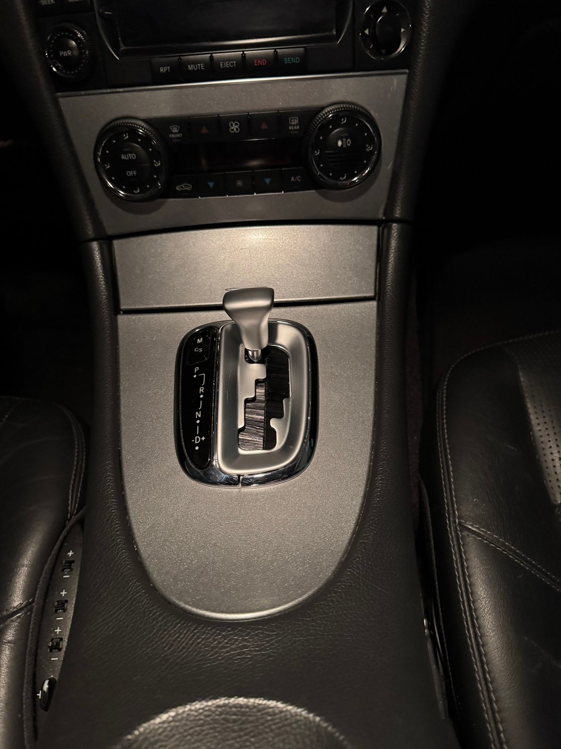

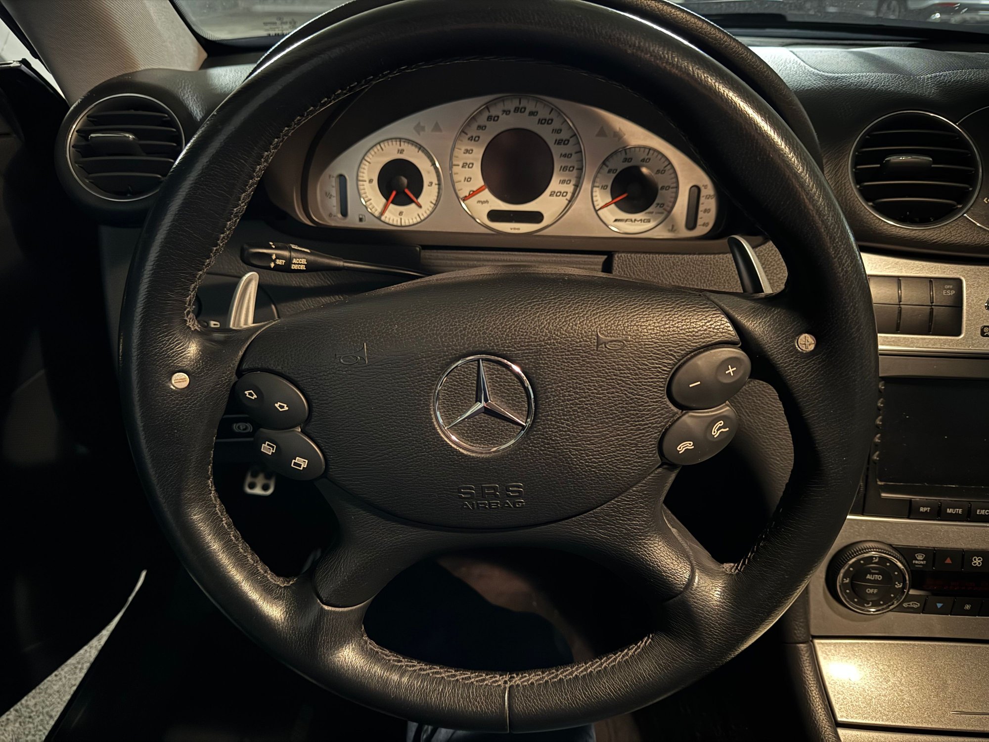

Just finished the install of a black series shift gate and knob, along with VRP paddle shifters. Great updates, I love the way it turned out.

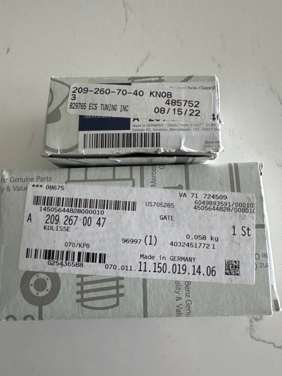

Here are the part numbers for the knob and gate, they are still available through a few providers. Google them and they will come up. What’s no longer available is the brushes that cover the area under the gate. I found some industrial brushes on Amazon for 5 dollars are modified them to fit. There are 3mm holes drilled in the bottom of the gate that I used to attach the brushes. They also worked to secure the gate to the base.

Why is the shifter gate scratched btw? And did you have to cut down the shifter to shorten it?
