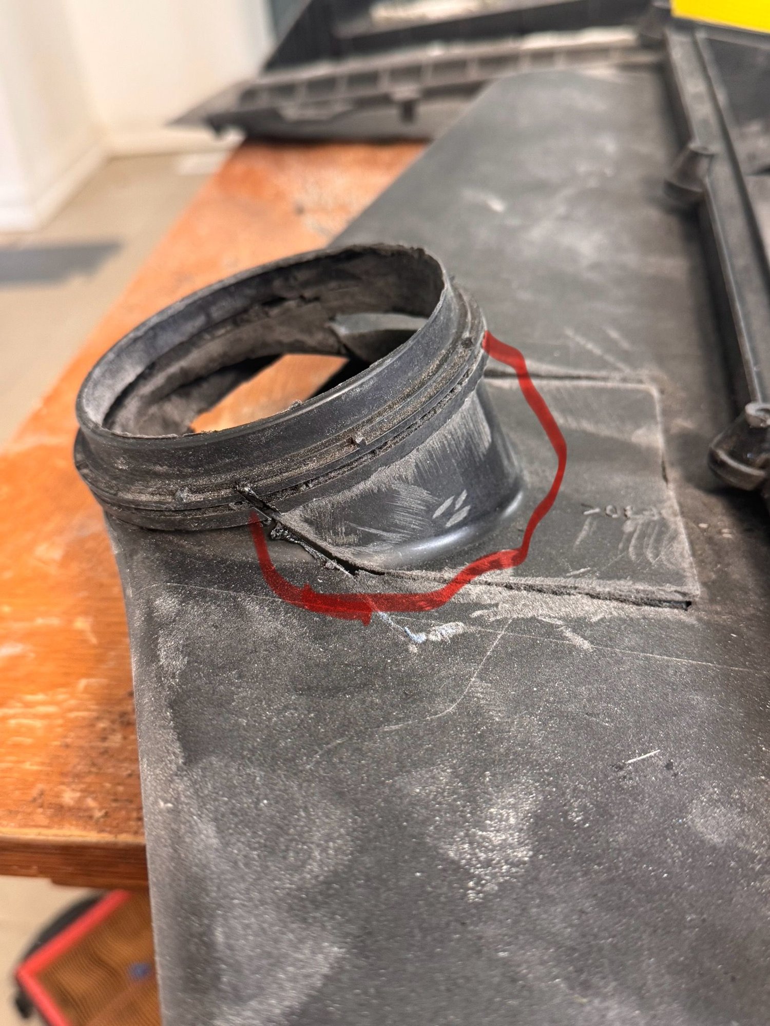

With some time on my hands (recovering from surgery) I came up with a way to stop the bottleneck our oem air boxes. The picture with the red circle shows where the bottleneck is. (Side note the pictures of the air box shows in primer and the other paint still drying…)

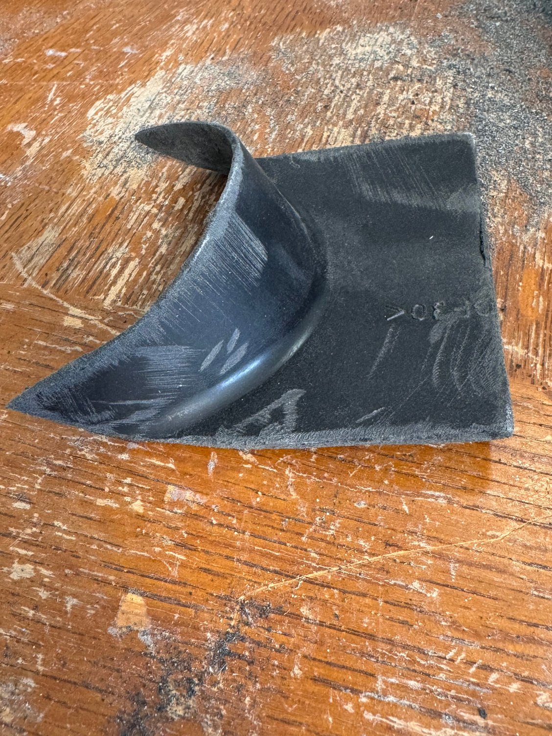

In the past I just raised the air box by splitting it in half. I’m still doing that but now I’m cutting off what I’m calling the THROAT. After cutting that off I raise that section so there will be a huge area for the engine to breathe.

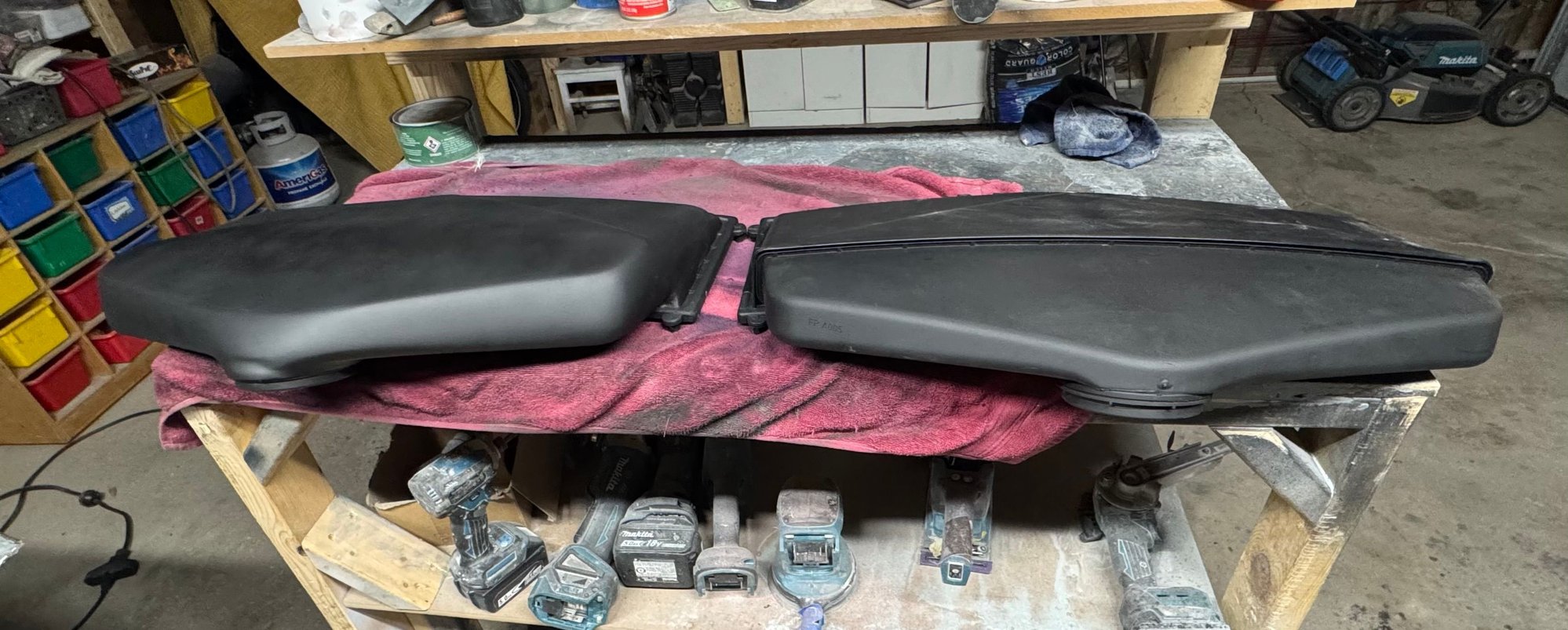

That step on top of the oem box is deleted and I raise the back part to be even with the back part. And inside that step is gone so you get better air flow.

In primer so you can really see the difference compared to the oem box.

Bottleneck that chokes airflow, specially at wide open throttle.

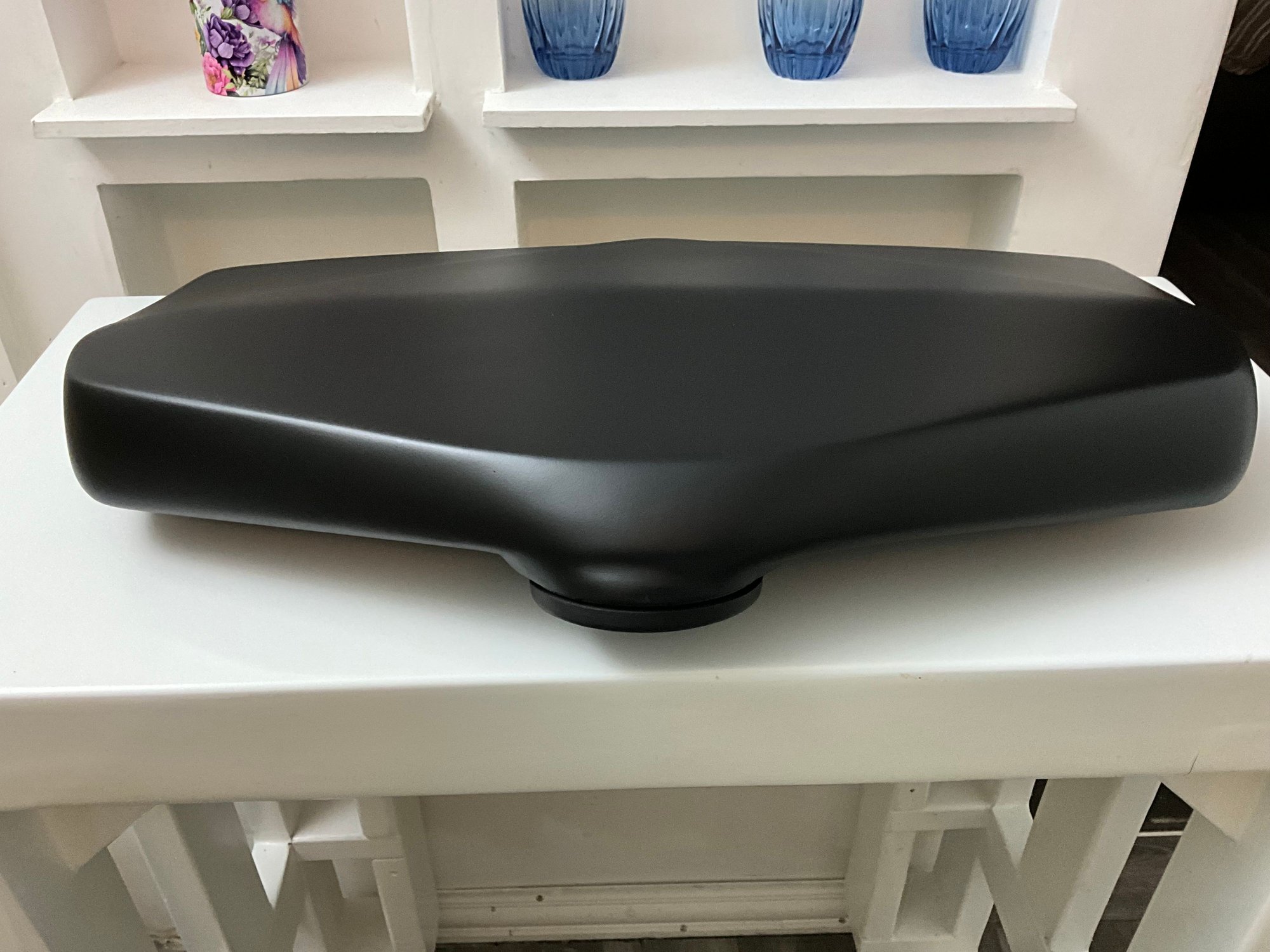

Just a nice looking air box that doesn’t take away the oem look.

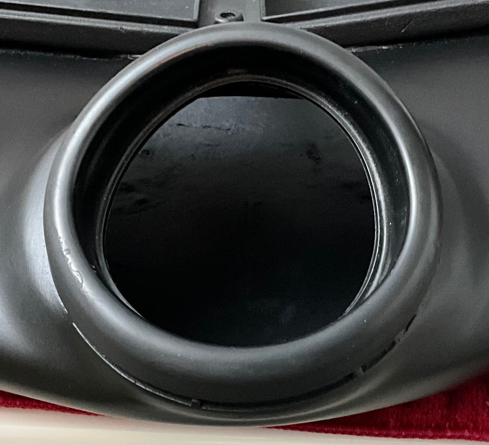

No bottleneck at all.

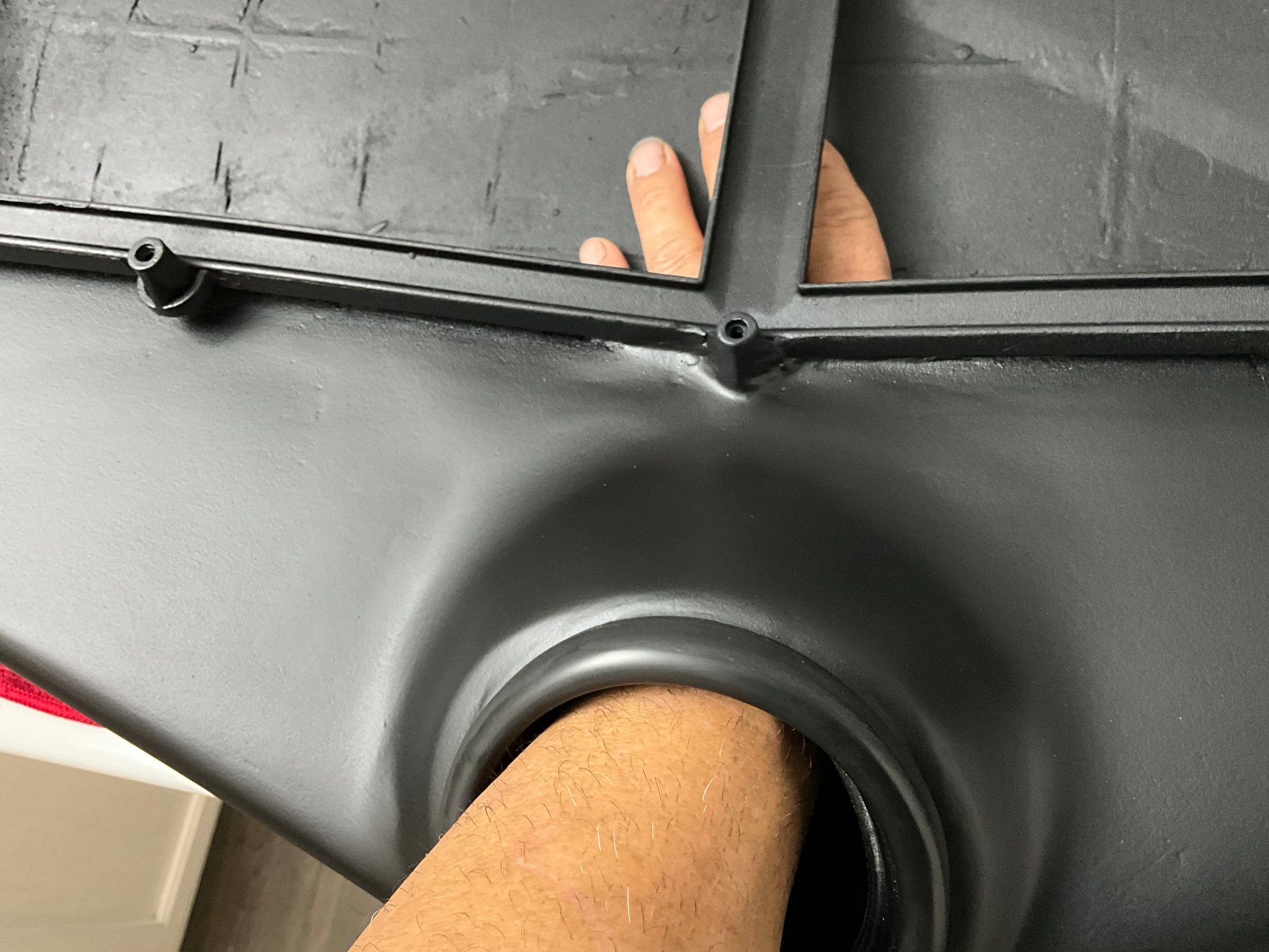

Try sticking your hand in the oem box. My box will allow so much more air to go to the engine.
