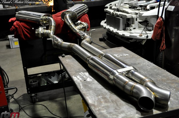

Sneak Peek of FMU Exhaust for CLK Black Series

...so where's the blown diffuser? That's the coolest part of the exhaust IMO. Did you guys change your minds on it? I saw the blown diffuser when it was like 85% complete in person.

A few
We had the blown diffuser off the car for the dyno runs, solely to remove any potential for the diffuser coming in contact with the dyno. If the aluminum were to bend or scratch off the powdercoat, we'd be F'ed, as there wouldn't have been enough time to make a new piece or re-powdercoat the old one. All the road-testing shots were done just before the truck arrived, so all the pieces were in place for that (same goes for the fireball shots towards the end of the video). The final set of fireballs at the end of the video (the close-ups of the tailpipes) were taken from an earlier video I made while the EBD was out getting powdercoated. It was a bit of a hodge-podge, but I wanted to make sure that I included as much video as possible.
We did a pre-SEMA iPhone video of the BS shooting flames, which you can see below. Granted, it's at night, but you can see just how crazy the EBD makes the fireballs as they shoot out of the tailpipes onto the diffuser.
http://www.youtube.com/watch?v=FWRQCKutF20
I'm going to have pictures and everything of the car (finished, in terms of FMU's work -- the front lip, roll cage and interior were done after getting to SEMA) up on the blog today, along with a description of the exhaust-blown diffuser and our reasons behind incorporating that design from Formula 1's Red Bull RB6 chassis.
Thanks for the kind words, though, everybody! I and the service techs are holding down the fort in Plainfield while the rest of the guys are in Vegas, getting the name out there. We have some crazy things coming up, from what I've been told. Keep an eye on the blog for more SEMA and BS stuff as the week draws to a close
-Andrew
Last edited by FluidMotorUnion; Nov 3, 2011 at 10:46 AM. Reason: forgot to say who "i" was.

I guess the flames are from fuel unspent fuel reigniting ion the hot exhaust gases but why does that happen on this particular set up?? Can some one explain??
The RBM Black Series is able to shoot fireballs so easily for a few different reasons in conjunction. Without giving away all our secrets, I can give you a rough rundown of what will help pop serious flames like that.
-Colder engines run richer
-Resonator/muffler choice plays into it
-You need a cat delete
-A richer-running tune has a better chance of popping fireballs also
Obviously the tune portion was out of our hands (Weistec handles software flashes for all their supercharger systems), but the rest can be done in the creation of a proper exhaust system. Start the car up, rev 'er up a couple times, and boom, fireballs.

Ours is significantly less intricate than anything being put out by the Formula 1 teams, and they have specific software maps to back it up (such as the ability to maintain a constant exhaust velocity even during off-throttle time), so while there's a lot more that goes into it, and a lot more that can go wrong, there's also a lot more benefit to be taken from it.
Ours is a bit simpler. Exhaust exits into the diffuser onto the "shovel" in the middle of each side of the EBD, which funnels it in a laminar flow through the diffuser, taking the slower surrounding air with it (as air is viscous), thereby speeding up the majority of the diffuser's airflow and adding downforce. With those diffusers incorporated into the underbody paneling, when the exhaust is blown through it, we're seeing a twofold increase of downforce at lower speeds. At least, according to SolidWorks we are. It hasn't hit the track juuuuuuust yet. But it will soon!

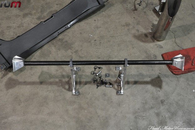

You guys should post up some pics of the bar and brackets in the trunk, I think it would help show how the exhaust blown diffuser works and transfers that downforce to the chassis I saw it in person and its self explainatory when you can see the entire set-up but might be difficult for peop.le to understand from these photos.
I love the BBS wheels on it too.

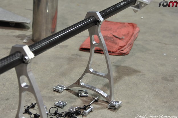

Definitely JR! Here are a few images of the rear bar design.
Initial Rendering:
Then, this image sort of gives you an idea of where the cut-outs come into play. When you they divert straight through into the blown diffuser. When shut, exhaust is pushed up into the mufflers and then dumped into the diffuser!
Thanks for the kind words guys, we really appreciate the support.
