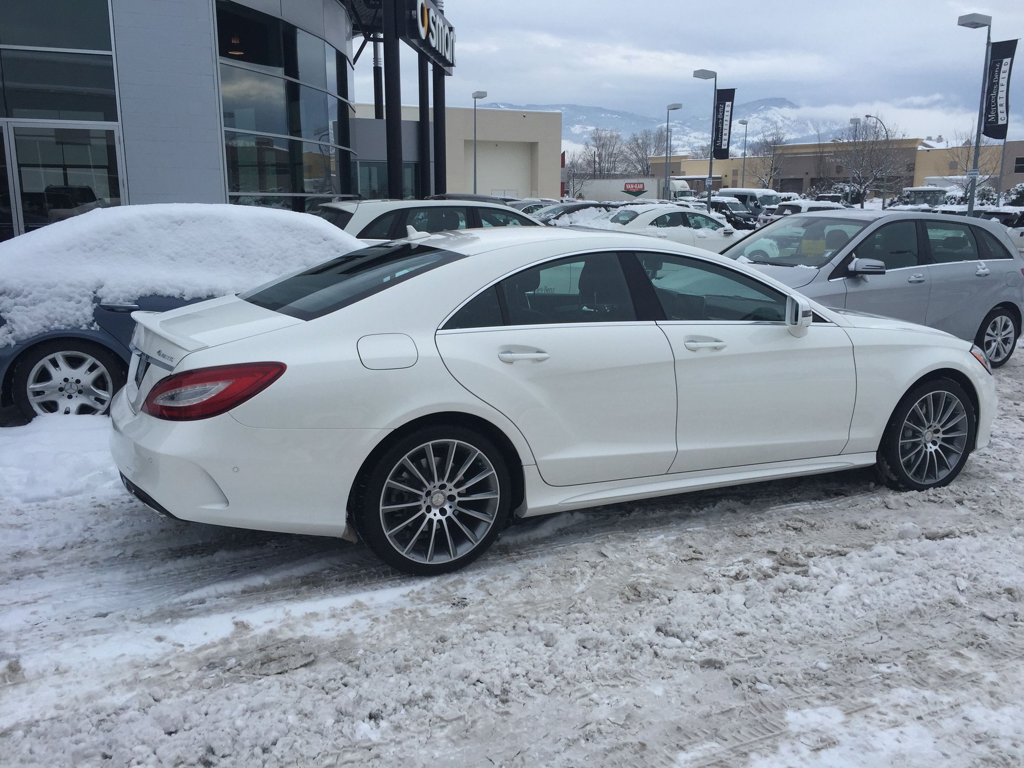

Just got my replacement 2016 and I am a happy mercedes owner again. Car is running the way it supposed to. No binding feeling after brake pedal release. No harsh 5-4 downshifts.
Unfortunately had to pick it up after a snowstorm!! I am liking the 9 speed but I notice it starts in second gear now in E mode. No other changes from 2015 and I missed the CarPlay build date start by a few weeks.

Looks good man... congratz
