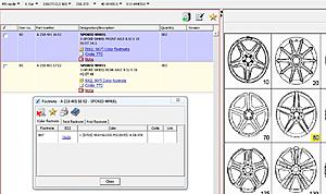

Can anyone tell me the difference between these wheel part numbers and which is the stock wheel for the 2014 CLS550 AMG wheel. A2184011602 and A2314011602.

218 AMG code 772 (AMG package) = front 2184010402 / rear 0502
218 AMG code 770 (wheel package + 1) = 2184011602 (or B66031486) / 1702 (B66031487)
2314011602 is for SL (231)
Attached Thumbnails 2014 CLS550 wheel part numbers-capture3.jpg   2014 CLS550 wheel part numbers-capture.jpg   2014 CLS550 wheel part numbers-capture2.jpg
