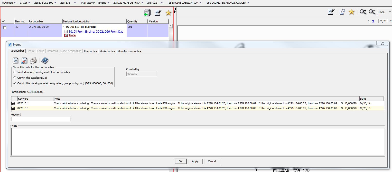

Sorry to bug guys... Been trying to find oil filter online and kept getting the wrong kind. Does anyone here that does DIY oil change can lend me a part number? it's for the 2013 CLS550 if that makes any difference. Thanks!

2781800009 however, read attachment note.

Yeah Konigstiger is right about the qualifier in the note. I had to buy both types of filters for a DIY. Only after I opened mine up did I know which one I needed. Then I returned the other one to the store. Take a pic of the box and part number of whichever one fits your car after you find out so you will be OK the next time.
